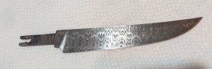

A friend has supplied me with a piece of damascus from Baker Forge for a custom build for him. He wants a black etch on the 1084 in the mix but balks at buying a gallon of Gator Piss from Baker Forge. I have in the past used lemon juice, ferric chloride or heated vinegar to etch the few damascus pieces that I have used or to etch a hamon in a piece of W2 and always hade an etch that came out somewhere on the gray scale. Any suggestions for a jet black etch would be appreciated.
I had success with Ferric chloride cut with white vinegar, repeated etches. I found that after the final etch, spraying it down with a water displacing oil (WD-40) seemed to "set" the darker oxides better than immediately wiping it down. I sprayed the blade down and hung it up over night to set in. Not sure if that's the "right" answer but it worked for me.
I did some steak knives in ferric, cut with vinegar. After three cycles they were a decent contrast, but more gray like you describe. I mixed up super strong instant coffee and left it over night. They turned amazingly black. I can wash and scrub them quite vigorously and it doesn't come off. It seems to really set the oxides, not just a coffee stain. You have to see it to believe it. I've got some carnauba wax to put on like Royer does.
The first shot is one knife before the coffee and the second is all five after coffee.
What is the ratio to ferric chloride, vinegar and water? And I have read about a coffee etch. I'll give that a go also.
I use 1/4 commercial FC etchant, and 3/4 vinegar. I do 3 etches, 8, 10, and 12 minutes, lightly sanding after each. For the coffee I filled a jar close to 1/3 full of instant powder, added hot water and put the knives in for 24 hours.
