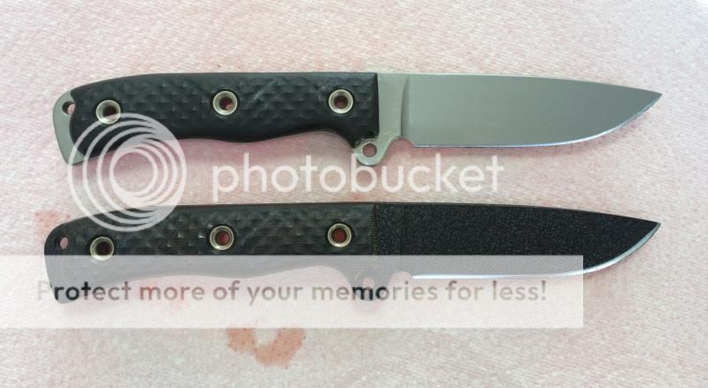

Here are the two most common shades of BLACK CANVAS usually seen on the Busse-kin blades...(note: The handle on the CG has more contrasted in the layers with a hint of OD Green in it)
Wet/Oiled (olive oil)

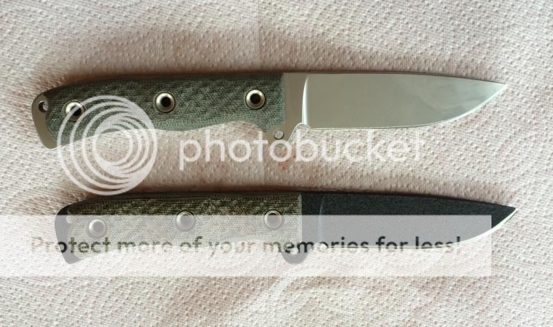

Excess olive oil wiped off (how I store my knives)

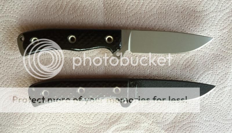

Washed with dish soap and hot water and allowed to dry

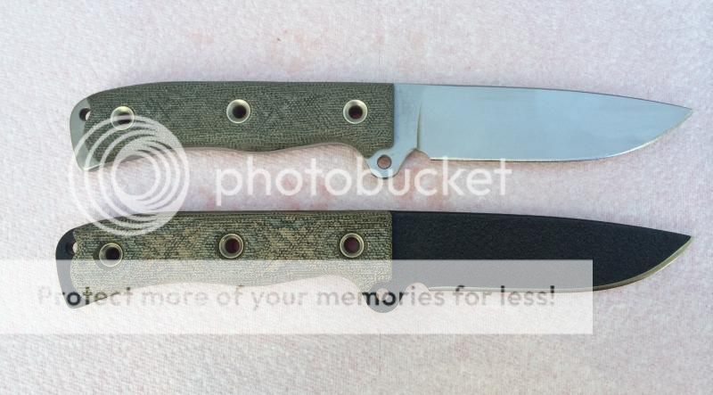

Sprayed down with GunScrubber (they are a bit lighter, but the clouds rolled in, so you don't see the difference from the previous pic that much)
These were taken indoors and the colors are MUCH lighter outside. I'll keep the knives out and try to remember to take a pic once the suns breaks through again this afternoon. but I hope this helps show the different shades Black Canvas can take on depending how much hand oils are on the surface of the material.

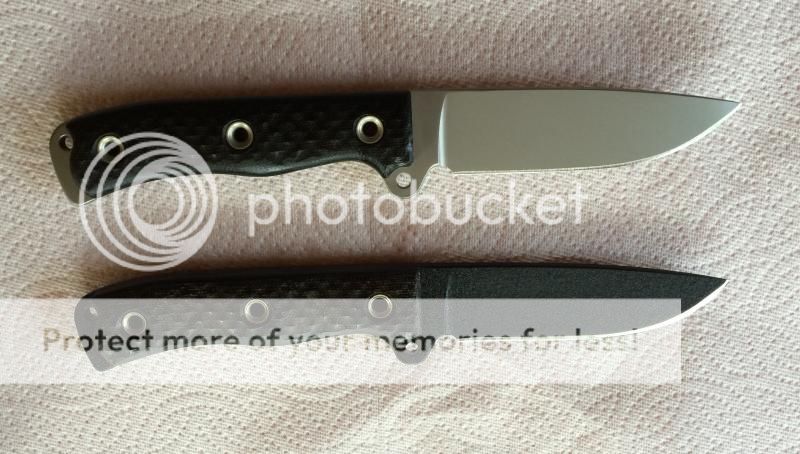

Still not super bright, but here area coupe outdoor pics...
Dry... (The top scales are a MUCH MUCH lighter gray in person than what the picture shows)

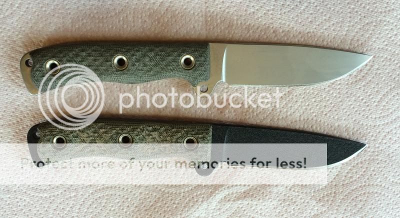

Oiled up for storage/carry...
