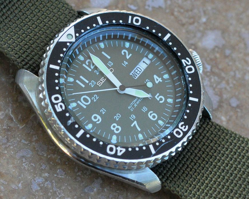

But back to your watch- I had a Seiko years ago that stopped and could not be restarted. Seiko makes a lot of watches using the 7s26 movement so I bought one on ebay for about $30 and swapped the movement out myself. I actually swapped the movement, dial and hands as a unit so it no longer looked like an SKX173. Since then I've had other Seiko watches modified with custom dials and hands. There are people that will do the modifications for you, just swapping a movement is fairly easy and would cost you under $50. I had found a watch works in the north east that specialized in this kind of work. You should be able to find them with an internet search. Another option would be to sell your damaged watch on an online auction and then buy a new one. Some years back I owned both a black monster and an orange monster. I bought the orange one new for just over $100 and the black one used for just under $100. Just like with knives, knowing where to buy is important.
This is a photo of the one that I restored myself:

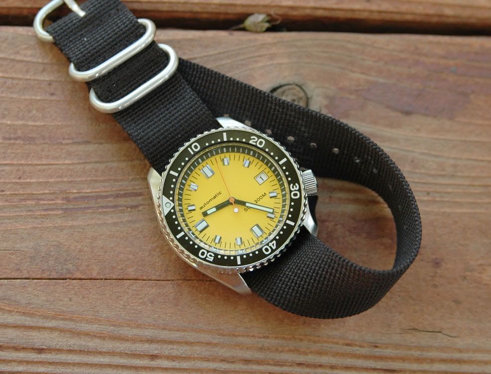

These are 2 SKX007 watches that I had modified by the watch works in the north east:
