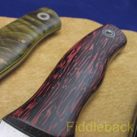

I work with a lot of black palm. It has to be stabilized to use as a knife handle. The nickname for it in the wood world is "porcupine wood", because it is a bundle of splinters. Stabilizing locks these into a solid block.
The biggest trick with palm to get a great look is to cut it on the bias. The end grain is dots. While that looks good, it lacks strength. The side grain has a stripe pattern and is strong, but the pattern is so-so. The best cut is at 45°. Also, angling the blade about 30° tilt while cutting the board at 45° gets an even nicer pattern. All cutting must be done after stabilizing.
Black palm works well on small knife handles, and is really attractive on fillet knives, because the bias cut pattern looks like fish scales.

I find it is worth those qualities because of a specific property of the wood that I really love. That is that it SELLS knives! Man, that stuff sells.
