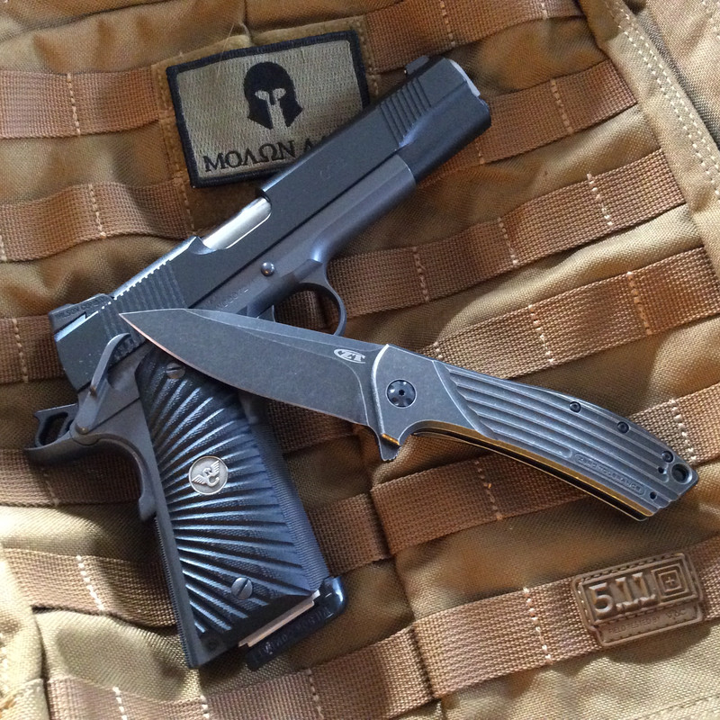

I have a ZT 0801BW with what they call a blackwash finish. If Lionsteel uses the same process, then you're GTG.
