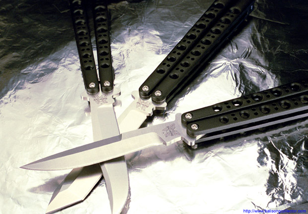

Here are the new Benchmade Bali-Song models. Clockwise from the top, the BM43BLK, the BM47BLK, and the BM42BLK.
The picture is part of my continuing themes of photographs that can not be taken in a light tent and photographs that incorporate highly reflective elements in addition to the knives.

Everytime I see pictures like this it makes me angry that I am not allowed to own Balis in Canada. It is something I don't understand, but have to live with.:(
I continue to experiment with digital photography myself. Could you tell me more about your light tent and why these were shot without it? Do the reflective surfaces represent artistic efforts or technical challenges?

Ah, the power of chucks pictures.
Very nice knifes Chuck, I'm thinking about picking up a 42BLK. Is there any difference in the flipping?

This picture is taken at a rather extreme angle so that the knives seem to disappear into the background -- depth. And, the illumination is uneven. The knives are sitting in a pool of light in the middle of the frame with darkness in the back and on the sides. There are shadows and reflections.
This sort of picture simply can't be done in a light tent.
