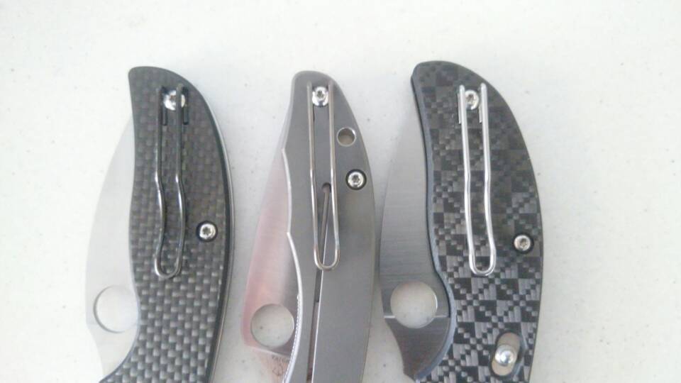

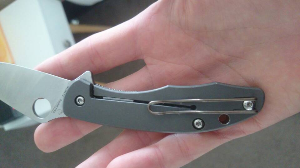

Thanks for all the comments. So I did the heat on the stove flame and cool in water method on a clip. I'm happy with the dulling. The pic's don't quite show how much more subtle the colour now is. It's almost a match to the titanium on my Mantra. Pic's for reference are a factory black Sage 1 clip, stove dulled Mantra clip, and a factory silver Sage 3.
