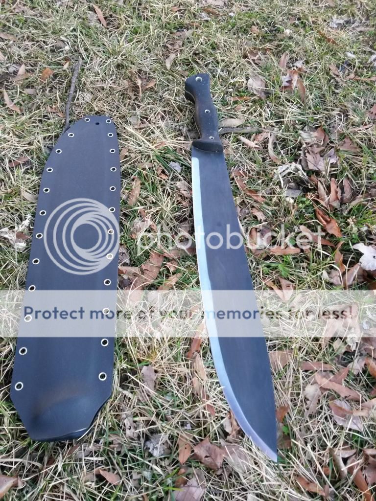

Here's a 52100 blade I finished recently. This is after about 4 minutes in a fresh acid solution using the method I posted above. Black as sin. I've also done ferric chloride and muratic acid. Muratic acid does not darken in my experience and ferric chloride works well but its not as quick as sulfuric acid and they only sell it in tiny bottles.
