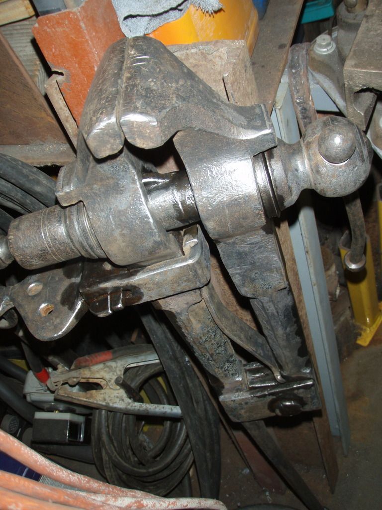

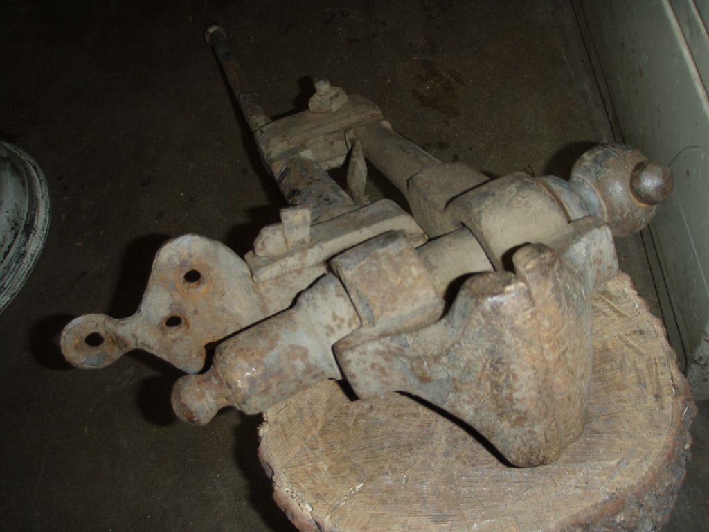

I spent a couple evenings this week cleaning up a post vise I found at some ole auction site.
There was a good, two hours of wire wheel cleaning in this job.
Happy smith-shop tool hunting! :D
There was a good, two hours o wire wheel cleaning in this job.
Thanks! That vice is cleaning up nicely!

@tangle thank you for that LoL, that pesky coyote is likely why good anvils are so hard to find these days, all of them are buried in the desert below some cliff. Also, nice work on the old vise.
