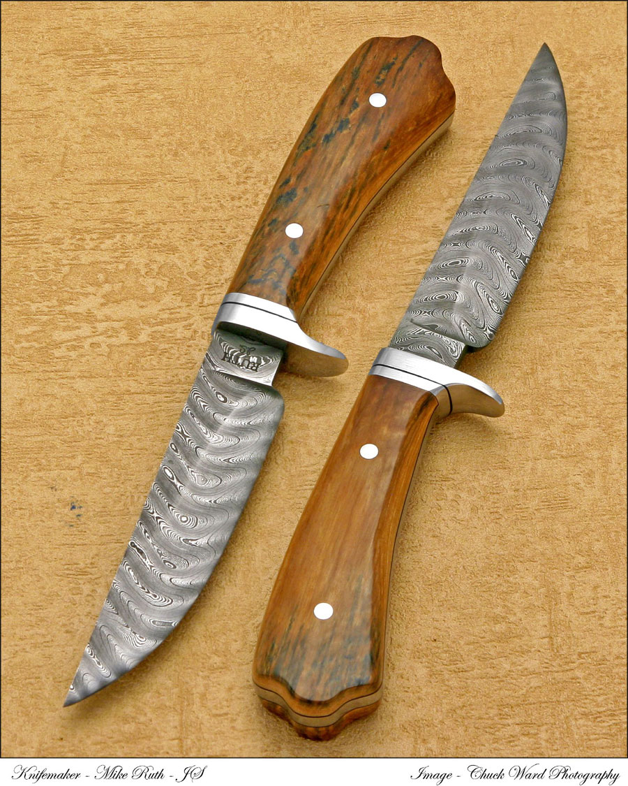

Here is one I plan on taking to Blade. Please let me know what you think, good or bad. The Blade length is 5" the steel is 320 layers of 1084 & 15n20. Mammoth Ivory. 416 Stainless Steel Frame Handle and Guard. Chevron pattern. Thanks Mike
Nice piece Mike - I lik the handle shape and the damscuspattern as well.
Roger
Mike, That's a great looking knife. I like the damascus pattern. Jim Treacy
Very beautiful indeed.
One idea: if the tang was tapered, it might give the handle a more light and slim appearance to compiment the slim profile and appearance of the blade.

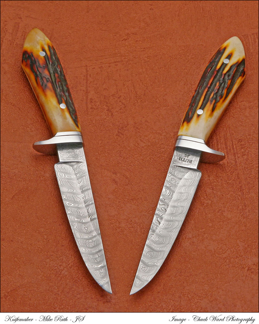

Here is one that will be going to Les. The Blade is 4 3/4" long.The Steel is 320 layers of 1084 & 15n20. The Fittings are SS. Amber stag Handle. The photo is by Chuck Ward. Please let me know what you think.
Mike
Very nice Mike. The first pattern looks like "west texas wind" pattern and the second a modified "wolf's tooth". Great execution of the steel.
Hi Kevin,
You have a good eye. The first one is West Texas Wind, and the second one is a true chevron pattern. I made the blade with stag first, and I didn't think the pattern came out the way I wanted it to. Even after etching I was not happy with it. When I finished buffing it, I changed my mind. The shimmer on that knife is outstanding. The photo does not show that.
Mike
Hi Kevin,
Mike
Other than no two pieces being exactly the same, I like the unexpected pleasant surprises associated with creating damascus the best. :)
Mike these are really wonderful knives super execution damascus and handle materials
here comes a but ..but not really a but per se but a question
have you or anyone looking at this post considered a tapered frame handle especially on a hunter/utility
I love the practicality of stainless frame but find the weight a bit annoying in hand especially on a hunter or ute.
I really like the shape of the butt of the handle on that first one. The whole knife looks darn fine to me. I think the second one looks great as well.
Great looking damascus on both of those! I'd be proud to own either one.
not that it matters, but since you asked, I'm not crazy about the bump on the butt of the handle on the first one. Without that, I think I'd love it- quite a lot- as the materials and proportions seem just right to me.
As for the other two, they look very useful. A nice, controllable blade profile and a meaty looking handle. Ready to go to work in style. Lucky prey! Again, great choice of materials and proportions.
