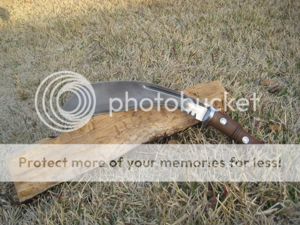

This is an interesting topic. I discovered that my ESEE 6 actually was not very good at making curls, unless I used the serrations. But, this below converted khukuri, which is quite thick, made wonderful shavings when the tip was planted and the wood was dragged along the edge. The only thing I could conclude was that the very sharp and nicely convexed edge was better than the equally sharp V edge and FFG ESEE 6. I was very surprised.
