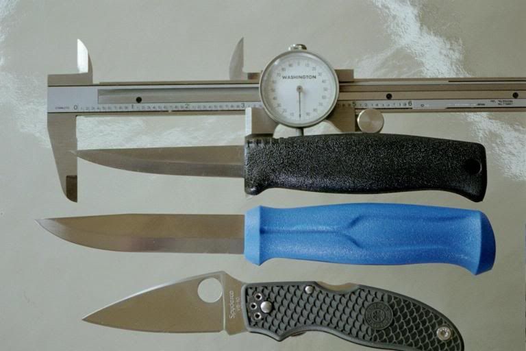

It would be difficult to estimate edge angles off a protractor because you would basically have to extent the angles, this can be done, but it tends to be highly in accurate unless you split them with a laser, which is how angle measuring devices actually work. Angles can be measured directly with a caliper on the bevel itself or you can measure the height of the blade off of the stone and calculate the angle. Both of these are high school trig problems.

Agree with gud4u, a caliper is a great tool for any blade enthusiast .... even look cool in knife photos IMO :) --
If you don't have one, they're good for everything from identifying all kinds of blade dimensions, size/pitch of screws, measuring depth and inside circumferences, etc., and lots of uses throughout the workshop/garage/home.
