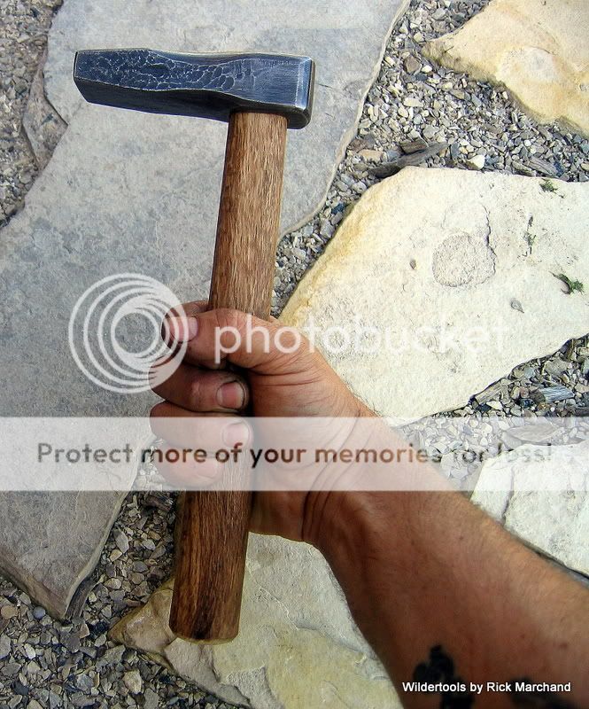

You may want to try a different type of hammer. I sometimes use a "shop-made" hammer that I forged out of an old ball peen. It is kind of like a crosspeen with a slightly different dressing. The shape of the striking surface tends to move the metal perpendicular to the hammer face rather than spreading in all directions. It makes it easier to draw down or push up your bevels with less lateral expansion(which raises the tip).
Rick, do you have a hammer picture thread with all the colloquial names so we can keep them straight?
Love that hammer and picture.
I agree with Rick that a "Dog's Head" hammer is tops for drawing down the bevels. I also have a lignum Vitae "swacker" mallet that is used to straighten and flatten blades as needed.
