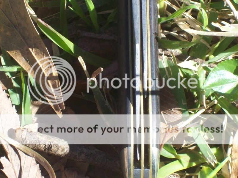

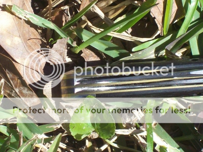

Just wondering, i've mentioned this before i think. But the clip blade on my GEC is slightly off center, its near the liner but not touching.
i wonder about it, especially as i've only had it since just after thanksgiving (although i have carried it and used it nearly every one of those days).
do your "old reliable" blade get like this? do they get worse over time or is it just what it is and i shouldnt worry so much
i've got a few pics to try and show what i am talking about.
I've never seen a blade really change its centering over time. I think it's just how it's born.
I have a GEC #85 in cocobolo and while the main blade is not perfectly centered 60/40 or so, it has never budged off that mark. As long as there is no blade rub, for an edc, I would not worry about it too much....and this from someone who is slightly ocd.....OTOH......you might entertain the notion of spa...sorry...that's ocd Peter talking. It is a beautiful knife. Your pics have turned me around on #85 with Clips!!!
Peter
While I have sent ones that rub back for refund or exchange, for one that I would EDC I wouldn't worry about the amount in your pics at all.
Blade centring usually won't change over time from what I've experienced or seen. I had a talk with Chris reeve on the phone about it and he was saying that it is usually just the blade being bent a little bit and that this is noticeable over the distance of the knife frame. Apparently this is a real burden for knife makers as it is essentially only an aesthetics problem and not a functional issue at all. None knife nuts will almost undoubtedly never notice such a minor thing but knife Knutson look for any kind of imperfection
Good question. I have often wondered myself if they move much after they are made. Do you have any brass gap gauges for automotive tolerance checking? You could measure the gap and watch it over time. Doubt GEC would mind fixin it for ya down the road if it ever gets to rub status. I have had OHO knives move but they are screw pivots, completely different.
i do not have any gauges :/
but good to know that GEC will take care of me down the road if necessary.

I believe you can have zero blade play when open but have some blade play when closed. Think if the liners are not perfectly parallel and the tang is not perfectly parallel in thickness also. If this is the case the blade could move around some when closed and appear off center some of the time. If it started of center and has not changed I would not worry about it. Its pretty easy to check for blade play closed and opened. This is what I would look into. Its a 1095 blade that pivots on brass liners, so its going to wear over time unless u keep your knife sealed in a dust free environment and oiled with an amazing lube.

OK, to specifically answer your question based on my experience (YMMV):
For #1 - Personally, I am not concerned with a blade being off center in my folders unless they rub. The little amount shown in your pics would be of no concern since it won't affect performance. If it rubbed though, I would send it back. To me, an instrument or machine shouldn't do damage to itself. This is either a design or build flaw when damage is done to a product by itself while performing its routine tasks. I want what I paid for, and that is a properly functioning product.
#2 - I haven't seen blade get more off center from routine use. This is probably the biggest reason I don't worry about off center blades. I have more than one that has the main blade that I use off center and the haven't gotten better or worse. In particular I have about three stockmans that have off centered main blades that I use to trim moldings, sharpen carpenter's pencils, open packing, cut shims, etc, etc. I am right handed, and the direction of the off center blade is such that I thought that by routine use it might bend or pressure the blade back to center.
Here we are at about 30 years of use, and no movement. Not better, not worse.
The knife you showed in your pics wouldn't cause me a moment's concern.
Robert

But, didn't you/we/They determine in another thread regarding this same knife and its issue(s) that your blade isn't off-center/leaning so much as perhaps keening slightly within its grind?
Wait, here we go (the post I was thinking of, within this thread):
This is kind of hard to explain, but when a blade is ground, in order to retain the edge as the blade curves up to the tip, a cam is employed to force the last few sixteenths of the blade into the grinding wheel. At the same time the blade is usually pivoted a bit into the wheel, again to retain that thin edge as the blade curves up. This is usually more pronounced on the pile side as that's usually the last side to be ground. Gives the illusion that the blade has been bent but it's really most often just the grind.
Eric
PS-n This is most noticeable on clip blades due to the geometry of the tip.
What is clear is that the way the blade is seated (or "presents") bothers you, still.
Maybe a return to GEC is in order, as others have suggested?
