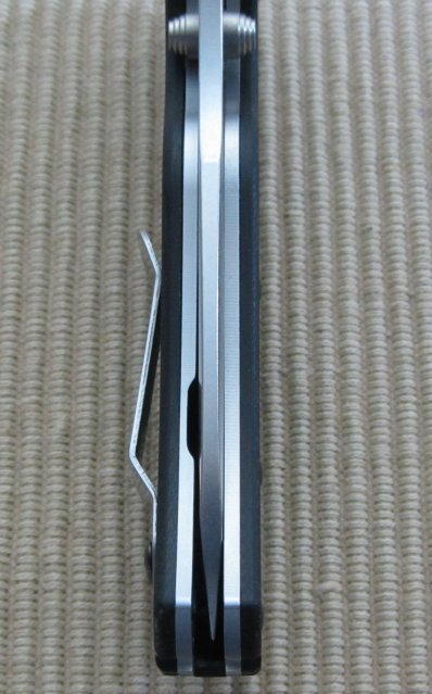

Just got my first ZT blade, a 0350. So far I like it a lot, it's built like a tank! The blade is a little off-center though, and I was wondering if there is an easy way to fix this. I'm not opposed to some disassembly, but I want to know what I'm looking for once it's disassembled. Thanks!
Sometimes you can adjust the pivot screw a little to adjust the centering. If you loosen it too much, though, you might end up with some blade play.

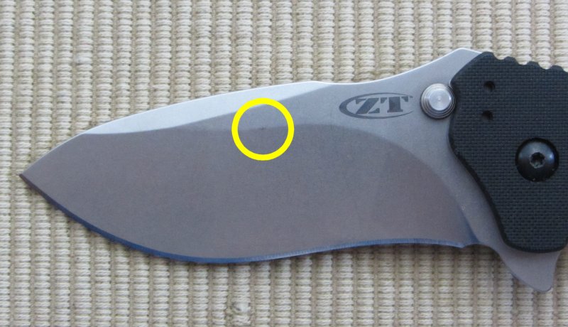

The center channel on the 0350 is just very slightly wider than the blade itself, so there really isn't much margin for error. Mine is a little off center as well, and the blade is rubbing up against the liner just ever so slightly. Not really a big deal for me, as the blade will likely take on more scratches with use. But if there is an easy fix I can do without shipping it back, I'd be up for trying.
Centering:
Rub mark on blade:
Loosen the pivot screw
Loosen the body screws
Move the blade over to the opposite side (opposite of which side it favors)
Jam a folded piece of paper, card board... Anything that will make it stay there
Tighten the pivot all the way
Tighten all of the body screws evenly, switching sides in between
Pull the folded paper out
Adjust the pivot to your preferred tension
This has worked for me on a lot of knives, providing the pivot holes are drilled straight, washers are the same etc...
Worked on my 0350 when I had it, you may have to do it a few times. This may also change the lock up. Usually make it earlier since the scales were not aligned.
