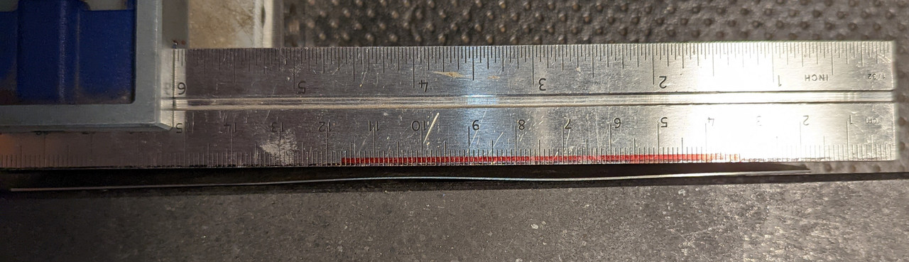

The difference from the referenced thread is that everything was good and straight after heat treat and an initial 45 degree bevel on the edge. I put an s-grind into the blade and it "popped" into being wavy. I can now push the blade edge back and forth to alternate the wave.
The question I'm hoping to answer: Is there any recovery to this situation? Or is it bound for the 'oops' bucket?
I am considering tempering at a higher temperature (low expectations), or grinding away the entire spine and middle to remove all but the hardened edge. Drastic, but it might allow the edge to go back to straight.
My theory is the cutting edge was under compressive tension after hardening and trying to expand. But the spine (unhardened) was thick enough to keep the edge immobilized. Once enough mass was ground away, the hardened cutting edge was able to expand by buckling and relieving the compressing force. Like a spring going sideways.

Image attempted below, showing the edge-on view of the blade below the ruler:
I tried to re-temper at 350F while clamped between 2 angle irons. No change.
weo - The shims didn't seem possible, since pushing on the wave inverts it. Put another way: There is a high point at the 10cm ruler mark. If I push it downwards it becomes a low point, and the 7cm mark becomes a new high point. Makes a fun noise when it flip-flops. Something like 'Broing'.

Good news! The carbide hammer was a success. Two blades were affected by this problem, and both look quite straight now.
What I did:
Use a carbide straight peen
Aligned to lengthen the blade (peen is perpendicular to blade edge)
Loads of light strikes. Maybe 200 in total.
Strikes were focused around the temper line (hamon) with some deviations to either side. The thought was that would enable the steel to lengthen where the most stress was located.
The carbide strikes resulted in some 'regular' bending that was quick to sort out using a mallet with strikes along the spine.
I haven't finished the blade out, but I suspect a few hammer marks will remain.
