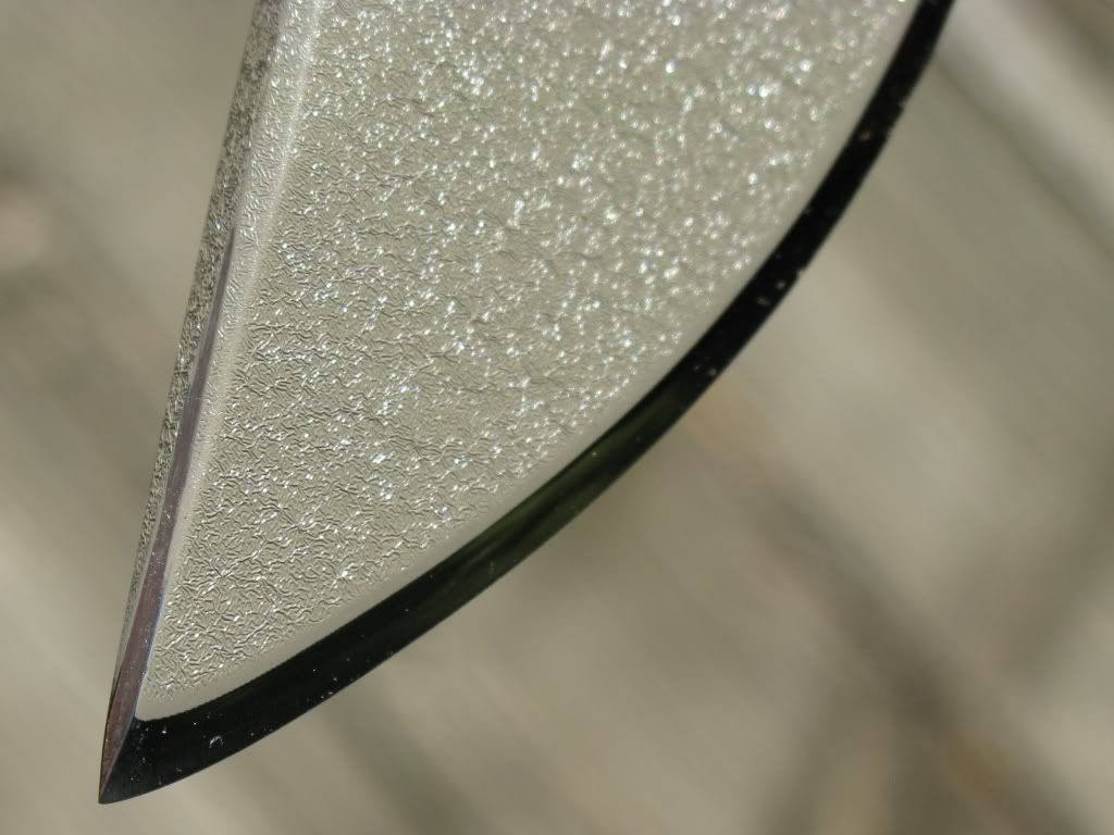

The Sage is about the same surface roughness as the standard black coating, and wears about the same too. They're both "crinkle" coats (so is the muddy you ordered). In general, I'd say that the black, sage, moss, and muddy are the most wear-resistant that I've beaten on, but that's also in part due to the fact that they're also the thicker ones too. One of the smoothest coatings is the jungle (dark) green, but it goes on pretty thin and doesn't wear as well.

The take-away is that the coatings can vary. IMO, the biggest factor in the wear resistance is the thickness of the coating.

ETA2: (lol) Here is a good close-up of the sage coating that shows the crinkle. You can see how thick it is along the exposed edge where it got smoothed when I polished the edge.
