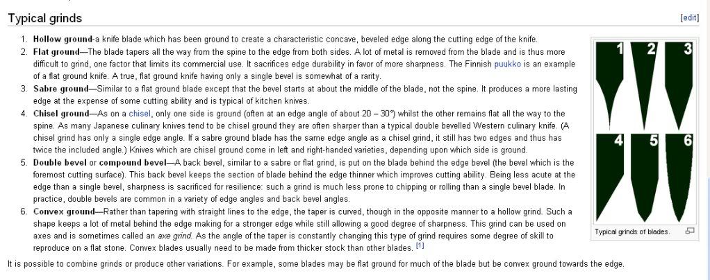

It is not a sabre grind. It is just sharpened on the pile side only.
Are you talking about a Chisel grind?
No problem, glad I could help. I actually snagged that off another thread awhile ago. Not sure where it originally came from.
Thawk, Hedger, Delmas mine is the OTG green delrin scaled version.:thumbup:
I could not tell you why Schrade made a chisel grind on that pattern. :confused:
It makes no sense to me. It could have been much more popular if they had made it with a flat grind or even hollow ground the blade.
