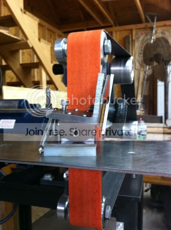

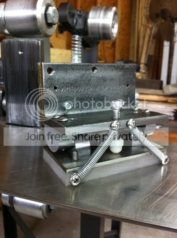

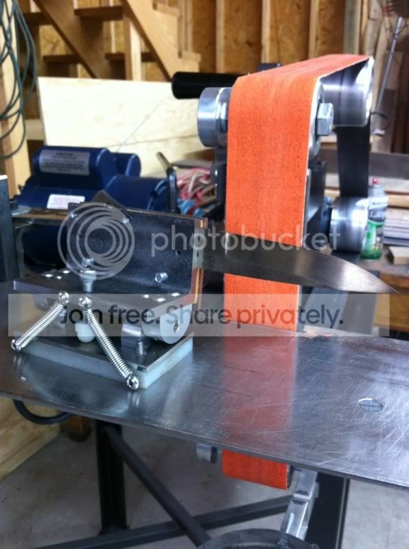

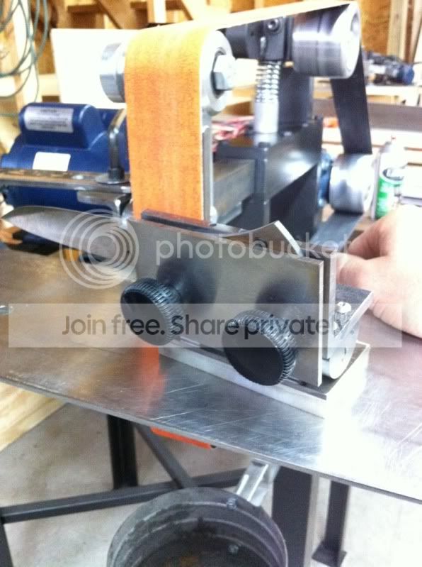

My adjustable blade grinding jig. Decided to make my own hinges.

I wouldn't say it's heavy. It's a lot smaller and more comfortable than my last one. The white stuff on bottom let's it slide easily on the rest. The pictures may make it look bigger than it is.
You could grind to completion on one side then flip. But I like to flip it around a few times to make sure I get everything even.
