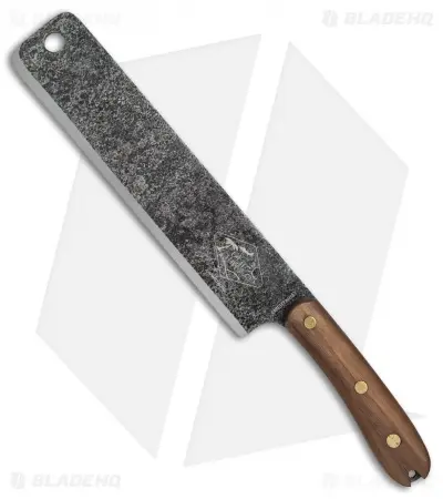

Yep, wide knives that are also thin are probably best for the kitchen but this thing from ESEE looks cool
.12 spine, so not a thick blade at all since this is a machete.
The extra width keeps some weight on the blade for chopping power.
Not a very tall grind either
