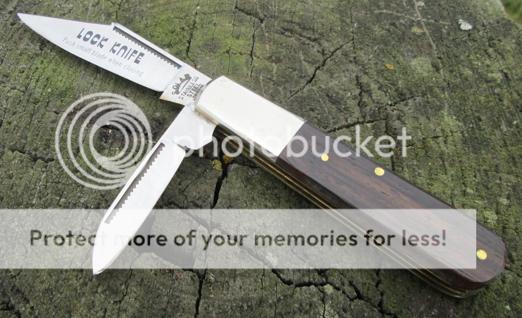

The only example I have is this late 60's Solar Barlow (Japan).
Why in the world don't more manufacturers use this feature?
I'm not sure. It MIGHT (or might not) increase the wear to the tang. The first oldie that I showed snaps like a bear trap but the second oldie has a worn tang on the blade that gets pushed down (other tang is fine). Schrade did use this design on their modern multi-tools but they switched to a liner lock for the electrician knives long ago.
