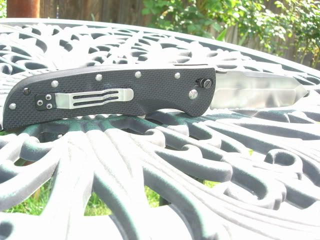

i have a cs recon1 folder that had a teflon coating. after some tuff jobs, the coating started wearing down and scratching off. i decided to sand it off and try to polish the blade... my results were ok, but not what i wanted
my question is; what are the steps required for a great mirror polished finish on a
aus8 blade? i went at it with 200grit then 400.. then i went on
to 0000 steel wool, and finished with some blue magic polishing
cream. i finished with a semi polished finish that im ok with but
not jumping for joy about. what should i do? did i skip to many
stages as far as grits on the sand paper?
btw, i searched for this topic and couldnt find what i was looking for, so i apologize if its already out there.

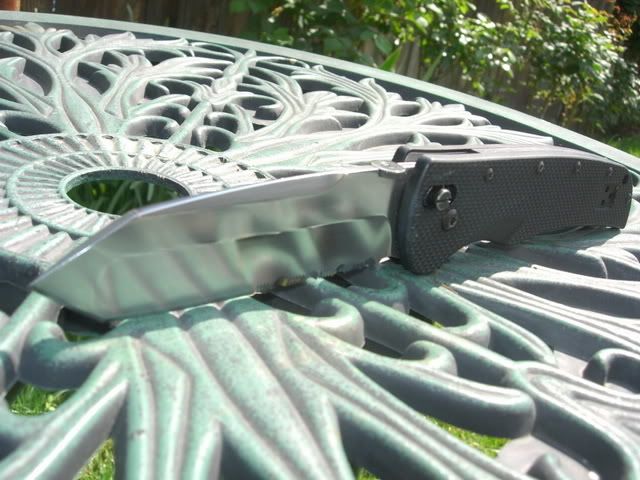

thank u both.. i was pretty sure that i was going to need to go up to the finner grits.. i posted two pics of what it looks like now with what i have done so far.... up to 400grit and finished with my dremel with polishing cream
i think your finish is just fine now :) if you go for a mirror finish you will have to polish often to keep it.. my H1 scratches real easy now..
i used 600, 1000, 1200 and 1500 and then polishing paste
this is true, and it being one of my edcs, i don't think i would have the time to touch it up all the time
