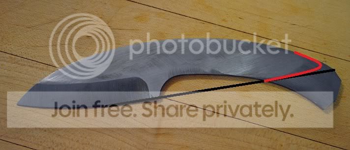

I'm looking for some input on this design. I originally was going to make it a warny with a fairly pointy blade, slimmer in the blade mostly by removing material from the edge upward, with it higher near the tang but ending at the same point. Then I decided that I wanted to keep some belly and a bit more blade thickness. The handle area is a very comfortable curve for someone with average sized hands. I'll probably put 1/8" thick scales on it once I settle on a blade design and finish up. If I don't change anything the bevel grind will climb a bit higher still, it's not quite finished but I wanted to pause here and be sure. Likewise with the underside of the handle curve, it's not fully blended yet but enough to get the idea.
Suggestions, comments, ideas? I've redrawn this one about a dozen times with another dozen blade profile tweaks, I just can't decide if I'm liking it because it works, or because it just works for me.
I just realized there's no scale for the image. It is 6.75" long right now, figure a bit smaller once I'm done. About 1.25" at the highest part of the blade.
I think it looks great. The proportions are very good and the lines and smooth and fluid. Ergonomically, I believe it will be very nice to work with as a general-purpose knife.
only problem I could see is the ammount of usable blade would be limited to about the first 1/4 of the blade when working on a flat surface, but freehand looks like it would be very usable.

Thanks guys. I agree that there's essentially no flat section to the blade but as a general purpose knife that's not the end of the world. With the length available I was running into the issue of any flat section making the rest of it look odd and this very gentle curve was the best balance I could find. Kind of ironic, given that the original plan was a warny but I wound up with a short piece of steel at the end of the bar and this worked better than that design.

It doesn't appear to be a very useable knife due to the curve in the handle.Certainly it is not a skinner. What is the use to be? You are asking for help. Frank
General utility. Not a skinner. The curve naturally keeps the edge of the blade facing more inward. It almost feels like an extension of your hand. Holding it naturally you get an edge comfortably placed to cut something on a table or the ground. The rest of the blade is curved up out of the way and is there for things like cutting rope or a box or other packaging. Think about a lot of smaller knives. You don't have the elevation on the handle to let you put that flat section of the blade on table top anyway, your hand's in the way. Instead you wind up using the belly or point most of the time for those tasks.
For me it fits the same niche as pretty much any EDC knife. It's not a skinner, it's not a bowie, it's not a chopper or dagger or fighting knife. Of course, if you have a particular way you want to use a knife this might not work at all, the lack of flat section but not sufficient curve compared to most knives factors in there.
Honestly, I'm not sure how the curve in the handle limits you in this case, the design tilts the blade down relative to your hand, and while maybe it looks too curved to be comfortable I can only say that both people who have held it find it very comfortable and natural feeling. The other person said it felt like having a claw as an extension of their hand, point and slice, so to speak.
I'm not saying you're wrong though, Frank. I don't have a specific job in mind for it. That's probably why I'm asking. It didn't fit an established mold to use as a reference. The original plan was a more traditional warnclif design with a less curved handle that gently sloped to the point.
Just as a concept, would you be more in favor of the design if I sliced the handle a bit to make it a bit straighter and then sliced the bottom of the blade off flush as a warnclif? That's one of the variables I sketched out. There's probably not enough left on the handle to really straighten it but I could definitely reduce that arc significantly. You get a more slim blade design top and bottom, fairly pointy but not too thin to hold up.
I think that you have a nice flow but if like others are saying it won't be as useful as it could be because you have the handle extend so much further below the blade edge. If you look at the attached picture that demonstrates my amazing ability to manipulate photos you'll see what I mean. The black line represents a flat surface, any of the handle under that line needs to go for you to really be able to use the blade on any flat surface.

Hmmm, why are you drawing the line from the BASE of the blade? Even with that line your fingers are in the way on anything this size so you have to tilt upward anyway. Draw the same line from the front 25% of the blade instead and you'll see how I'd use this on a flat surface like a table top. On the other hand, what am I using it on a table for? I can't remember the last time I used anything but a chef's knife that way. Even a paring knife won't let you get the blade flat to the table unless your hand is off the end of the table so the handle doesn't matter.
It's a good idea though. Maybe I should trim some off the handle no matter what, just to at least give the option of using more of the blade on a flat surface
I want to take a crack at that question, even though it wasn't aimed at me. I'll answer by asking another question... what is the purpose in continuing the grind past the point at which it can come in contact with the surface being cut? You ground the edge back to the rear 25% of the blade. If you only intend to use the front 25% isn't the rest of the edge superfluous?
Mind you, I can think of answers to my own questions, but those answers would be based upon alternative uses. I couldn't say whether anyone would agree that the knife design is appropriate to those uses, though, because I'm too much of a noob to know such things. ;)
- Greg
If you wanted to cut something on a flat surface then yes, only the front 25%, but the rest of it would be handy for anything else except when using the point itself.

I didn't change anything before HT, just finished up the bevel and cleaned up the profile since it was still rough edged. HT went well and I'll put a quick edge on it tomorrow and we'll see how I like it in practice and not just theory. I left the bulk of the tang un-hardened so I'm free to make any of the tweaks to it that you guys suggested.
And here are a couple pics. I'm tentatively calling it the Talon because of the comment about it feeling like a claw. I've left it pretty rough post HT, just sanded a bit and put a basic edge on. Despite being a chisel grind I put 15% secondary grinds on either side for the edge, I have been meaning to try this and figured if I'm making a test knife I might as well get the most testing I can out of it. :D
I'm not liking the angularity at butt. I'm thinking I'll round it over into a smooth curve when I put the scales on.
