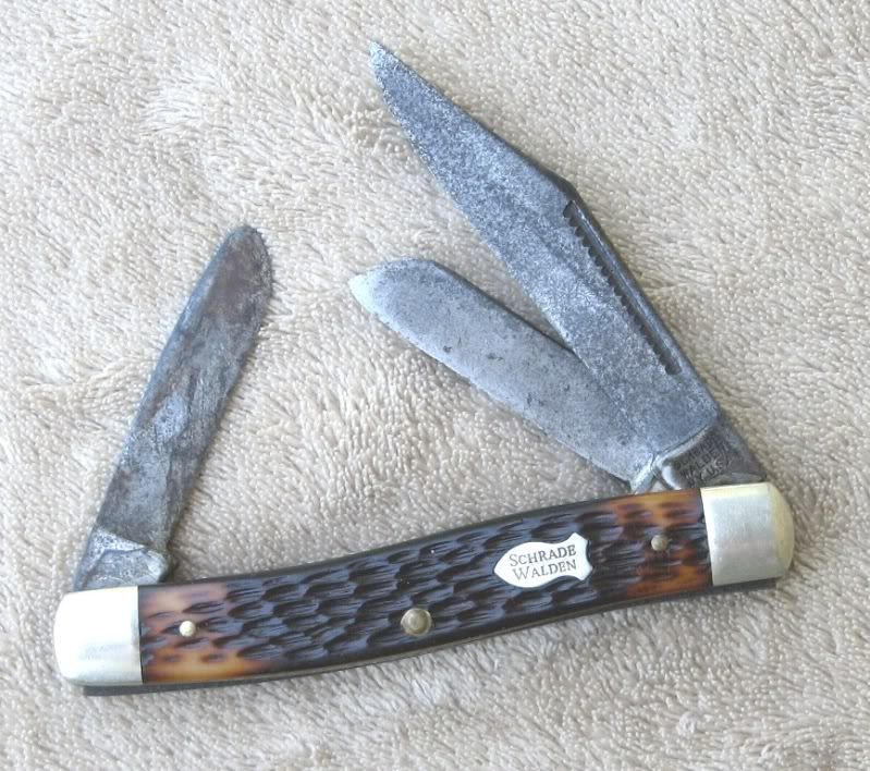

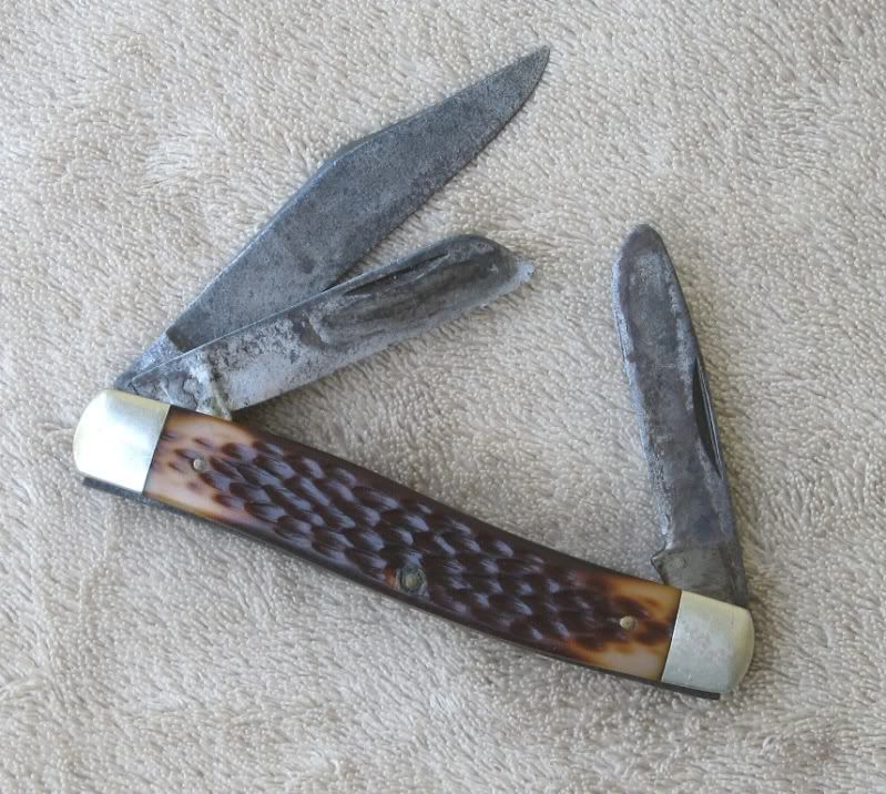

Let me know when that product comes is available. Check out this Schrade Walden 881 that did not live in a dry place for a couple of decades:
The knife appears to be unused. I got it in a plastic tube with no end cap. I just oiled it and rubbed it with a rag. Before oiling the blades were stiff without much snap. Now it snaps like a turtle. The blades are smooth, just tarnished, although a few places are showing signs of light rust. I think I will try and list it as a prototype "special damascus edition".
Seriously, what advice would be best to make the blades look decent and keep the rust from coming on worse. I've seen knives like this taken to a buffer, and I don't care for that look, and I don't have one anyway.
I can't say for sure Hal, because I've never had one that bad. I've read of guys using Flitz and fine steel wool to get some of it off, and others that use wd-40 and steel wool. Either way, she looks like a great knife, just needs a little TLC.

:eek:I would glue down 400 or 600 grit (depending on how deep the pitting is) emery paper to a smooth flat strip of wood, right to the edge, anchor the wood, and carefully rub the flat surfaces, keeping them flat. This keeps the edges crisp. It's slow going, which is what you want. Then get some green polishing compound, glue down some hard leather, or buy a ready made strop, and finish it off, keeping some compound on the leather.

this is basically the same method i use when a knife is so far gone that it actually needs a cleaning, but as you can see from my 165UH thread i didn't go too heavy. on that knife i just wanted the rust gone. what you see remaining is some pitting. i didn't have the energy nor the desire to remove that much steel on that blade. i think it has character.
as for the knife pictured here, if the blades are not pitted, the method mentioned above will work perfectly! use wet sandpaper, use the water too. :D a large paint stirrer works great for the wood. and you might try wrapping the sandpaper around the stick as well. just a few more thoughts.
