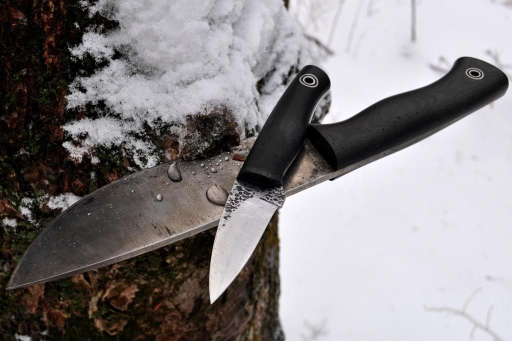

For anything except battoning and chopping (not much point with a 4" knife imho) 1/8" is better. 5/32" with a high or full convex still slices very well and battons better. 3/16" is probably not needed, but gives a warm and fussy feeling :D (makes the Camp chop and batton very well though)
My pair: 1/8" Ladyfinger in S35VN and 3/16" Camp in O1

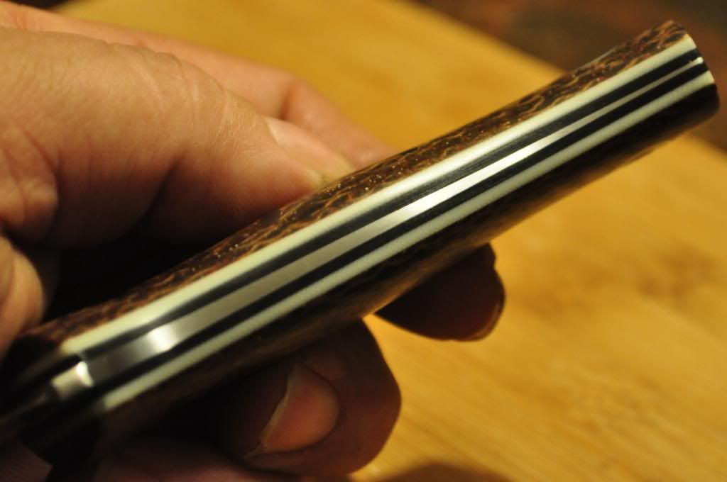

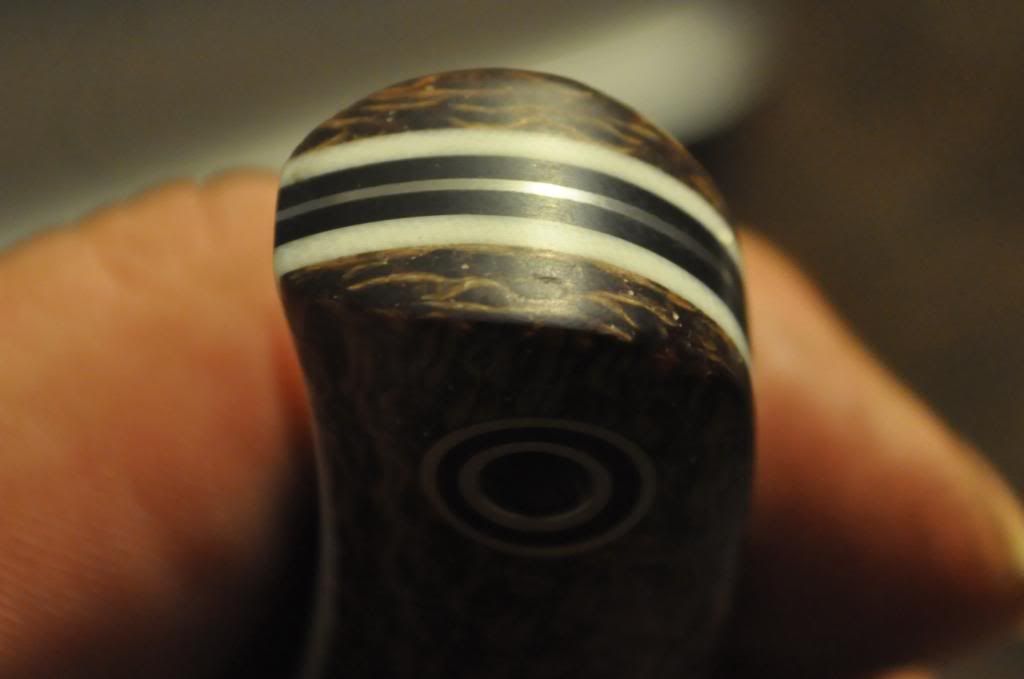

The Raptor I edc these days has a Wharncliffe-ish / sheepsfoot-ish type blade that is 3.5 inches long. It is 1/8, or 0.125” with a full height grind, and thinly tapered tang. Very light-weight on the belt and slices even soft cheeses like Havarti easily, and very handy to have around, so I don't foresee a need for a thinner one for me personally, but I suspect there will eventually be a 3/32 / 0.090 version offered in the future. Now that Christmas has come and passed, and we have had a heat wave where temps have hit the mid to upper 30s the last couple of days, and most of the ice has melted off the trees, I will be getting out and working it more in the woods. I suppose I have been more hesitant with the convex 1/8 due to the more mass removed by the grind, and background assumptions regarding reasonable use with thinner blades. I have been waiting on the right full sized bushcrafting knife in a blade profile I am more comfortable with in bushcraft tasks...like a Kephart, or maybe a Terrasaur or KE Bushie (yes I like pointy) with a less-than-full-height convex grind in 1/8 to put through a long term work out in the bush. However, looking at all of the common thoughts in this thread, I think it is just time for me to give the 1/8 convex a good, long term, work out in the woods in various tasks....so the Raptor will just have to do. The upside of that is that with it being full height, and having a thinly tapered tang, anything it can handle, a convex 1/8 saber grind with a SFTtang will easily handle.
I do have one Fiddleback in 3/32 thickness, it's an ED Karda, and it is a perfect team mate for my Camp Knife. It is also a hybrid blade profile being somewhat of a cross between a below-center sear point, and a Wharncliffe-ish type blade, but the blade length on it is about 2.5 inches.
I think Andy's 1/8" stock is awesome. I've batoned through quite a bit of modesto ash (no knots) with my Terrasaur and it holds up really well. I honestly think, unless you're really going to abuse your blade, 1/8" can handle just about anything. 5/32" is pretty awesome! That stock you can beat the living day lights out of. 5/32" is really an ideal stock for anything. 3/16" well that's just the 50 cal of his stock. A little on the heavy side, it will kick the you know what out of anything around camp.
I think Andy's 1/8" stock is awesome. I've batoned through quite a bit of modesto ash (no knots) with my Terrasaur and it holds up really well. I honestly think, unless your really going to abuse your blade, 1/8" can handle just about anything. 5/32" is pretty awesome! That stock you can beat the living day lights out of. 5/32" is really an ideal stock for anything. 3/16" well that's just the 50 cal of his stock. A little on the heavy side, it will kick the you know what out of anything around camp.
The reason I was holding out for a Kephart or similar is for the more blade length in batonning and truncating, but I have done quite a bit of batonning and truncating with a 1/8 scandi Hiking Buddy, so I should be able to manage fine with the Raptor. Part of it is that I have just become spoiled to Andy's tapered and SFT tangs lately and so the full tang of my Kephart sort of throws me off when I use it now. So, obviously part of it is just me grasping for a viable excuse to get another Kephart :D

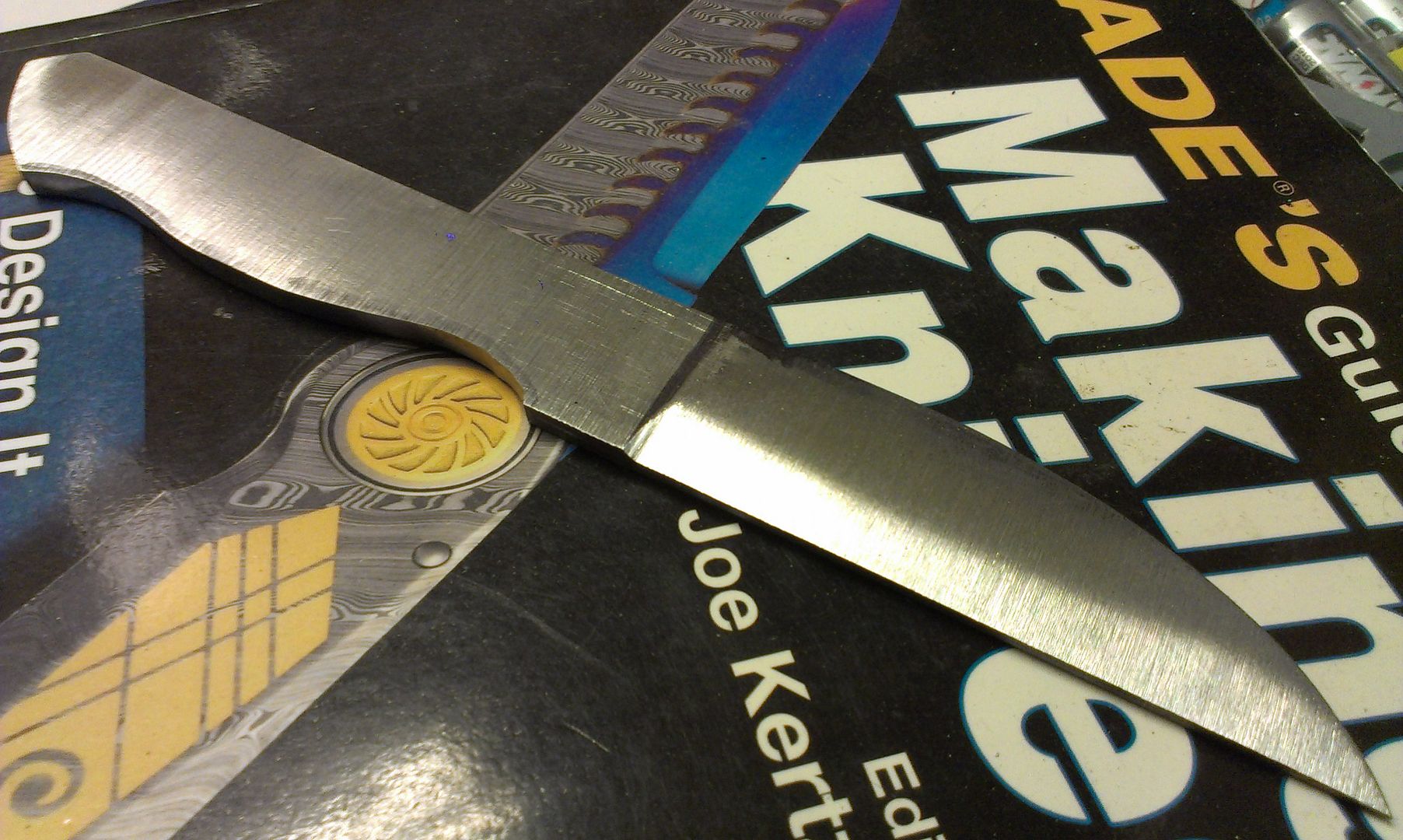

I was tortured trying to figure out if I should spec 1/8 or 5/32".
I dabble in making knives and I'm working with 5/32" now.
(5/32" 1084)
Honestly it feels a bit thick for the wharncliffe I'm making, but on the Kephart that I'm getting from Andy I'm going with the thicker stock.
It's 100% a mind thing. I've made knives (well, more like 1 knife) with 1/8" 1095 and I believe it to be perfectly solid, even for batoning. Still, the trade off i slicy-ness is just negligible enough in a full height grind to make it worth the added peace of mind.
