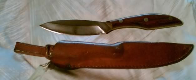

I have a 'Russell Belt Knife' that I bought while working as a forest ranger in 1965 that survived that use well. Even though it was carbon steel I had no problems with rust. A couple of years ago I got it out and 're-conditioned' it. It took a razor sharp edge just the way it used to.
Greg

The Russell Belt Knife is another great choice as an all round piece as well as the Mora 2000. I think in general the trend towards ultra thick blades is a fad. Most of the time you are not going to need a 5/16 thick blade for anything, but, they are tough as a tank and might survive outside the normal limits of knife use/testing which seems to be a very popular trend these days.
