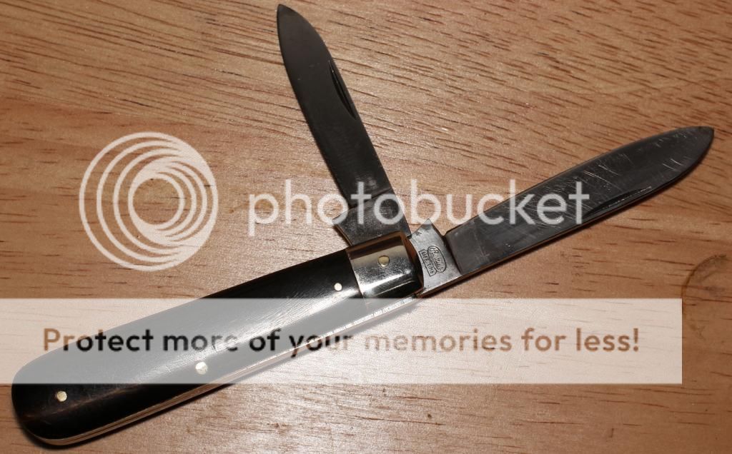

I've got a nice old German made Jack knife with horn handles but it looks as if both blade tips were once used to pry something or perhaps loosen a screw. I've gently tried hammering and even applying some light pressure by holding the very tip in a vice. It is so springy, my attempts have had little effect. I'm afraid that any more force will simply snap the blade.
Has anyone had any success with a similar situation?
Any assistance would be greatly appreciated.
Thanks, Ed

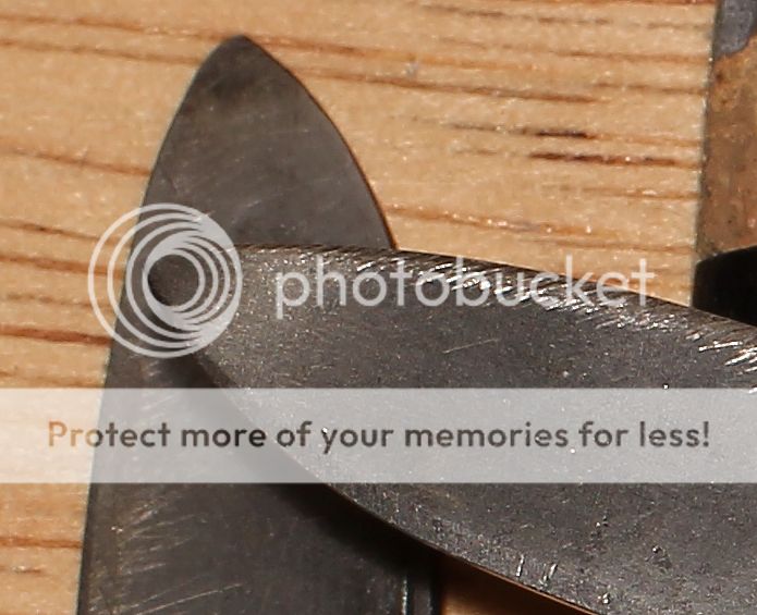

No photos of just the tip... slight bends at very tips like they used it on a screwhead...
The bend is not just at the blade cutting edge but the entire width at the tip - I'm just afraid to apply any more pressure.
