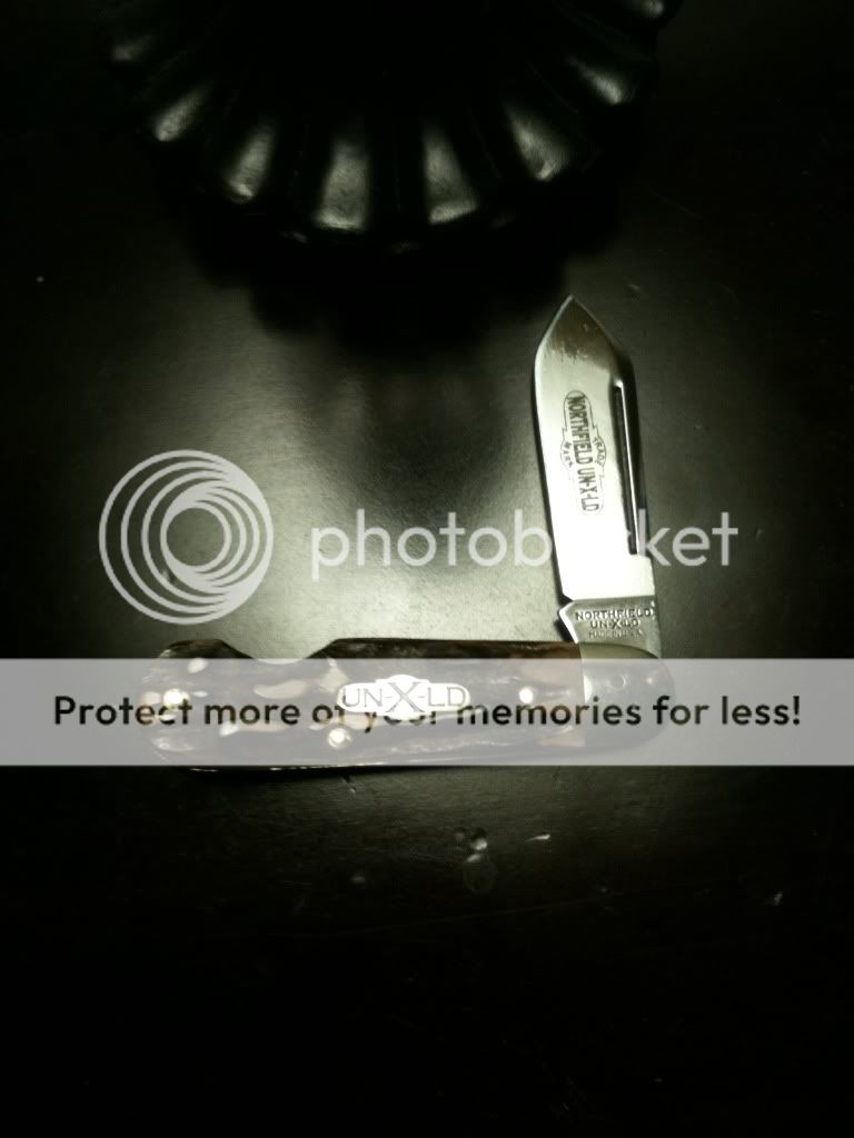

Here's a picture of the knife
I'm wondering if that technique may crack the stag?

I think there's a reasonable risk in that. I would avoid it if you're worried about that.
I think I made a small hairline fracture in my Trapper's handles. Not too big though, but I kind of wish I had just warrantied the thing. I just got done sharpening and forcing a patina and didn't really want a brand new one though.
