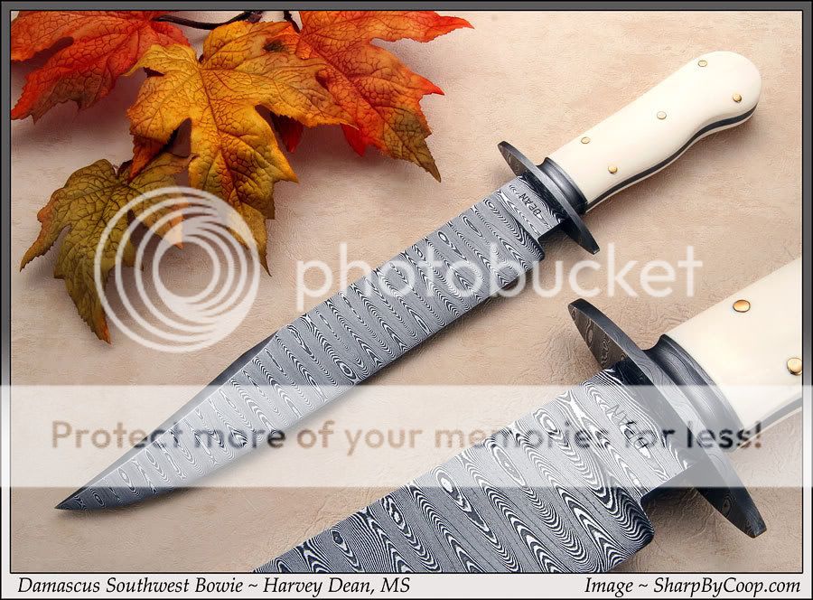

I like blade shape of following bowie a lot (though materials used are different story):

Personally I also would like to see more symmetrical flat guard, like the Harvey Dean posted above.

The Harvey Dean knife shown is gorgeous, but I think the blade looks too straight and somewhat narrow/skinny. It could have used a little "S" curve in it and a wider blade, IMO.
