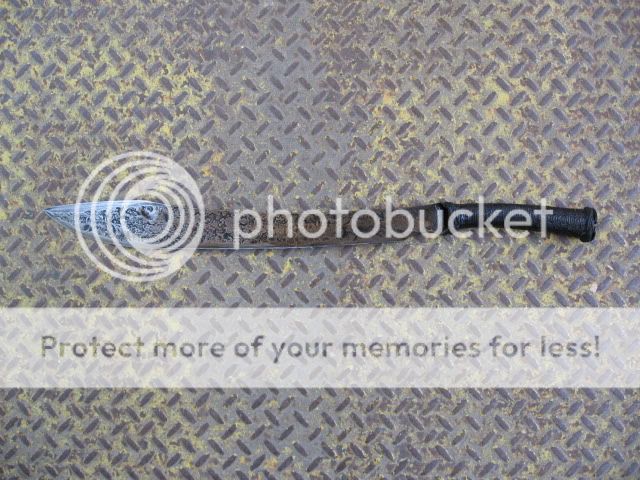

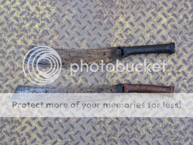

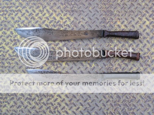

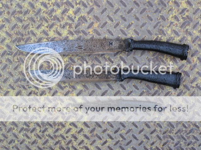

1.) Six socket-handled big blades. These are all forged from leaf spring, multiple hardened in veggie oil and given multiple tempering cycles. Handles are hemp cord wrap with cotton cord Turk's head knots and amber or black shellac sealer. Each one has a handle long enough that, in conjunction with the large choil, one can use it for a two-handed swing, or at least hand-and-a-half if you have gorilla paws like mine. Four of these are almost willow-leaf saber profiles, and I would consider them more of a bush sword than a machete. The other two are Southeast Asian style blunt-ended choppers.

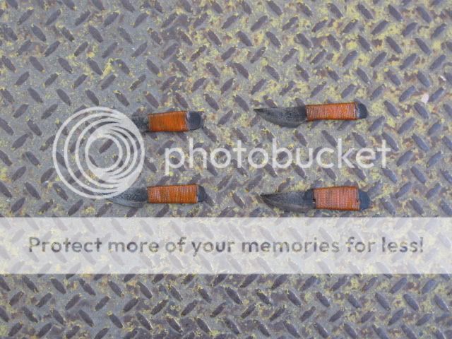

4.) Four personal survival kit knives. A more substantial solution than putting a razor blade in your Altoids tin PSK. Two-finger grip, and shaves hair nicely. Made from plow disk, hardened in veggie oil, with high-visibbility orange nylon cord wrap sealed with epoxy. Charlie was sure eyeballing these.

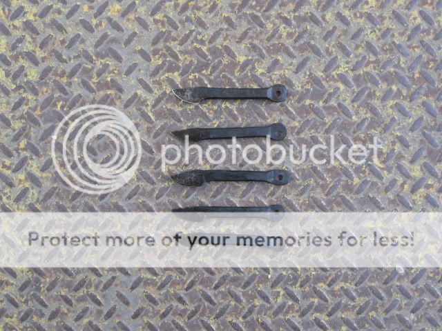

5.) Small game gigs. Made from agricultural coil spring, hardened in veggie oil. You can lash it to a pole to gig fish, frogs, squirrels, etc., and the blade is large enough and sharp enough to process the critter aftewards.

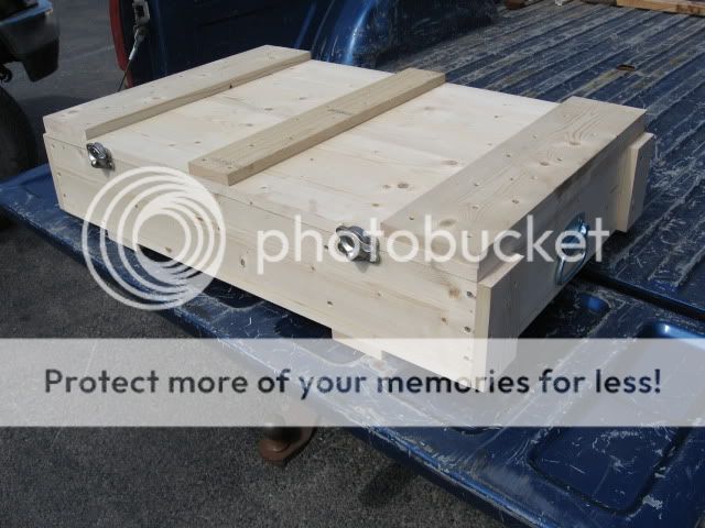

And finally, the reusable crate I had made to transport it in. I based it loosely off an old rocket box I have, but scaled up. There's a small chamber on one end to keep the small stuff in. I need to stencil "Helm Enterprises, Forging Division" across the front now.
