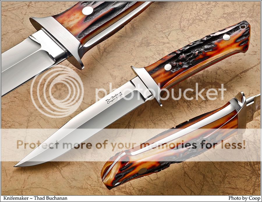

Thad Buchanan is grinding outstanding double edge fighters in the Loveless tradition:

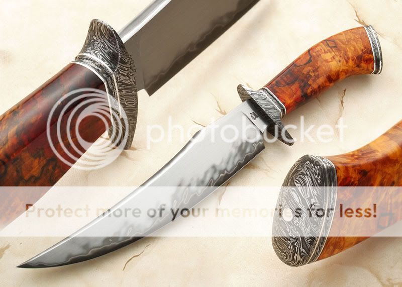

Burt Foster shows why laminate blades are super hot:

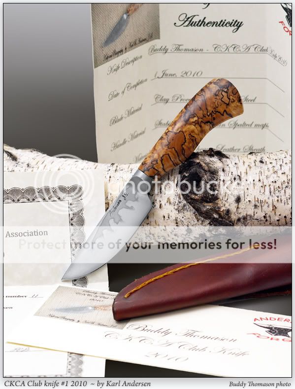

And how can you have a blade thread without depicting a expertly executed hamon as demonstrated by Karl Andersen's CKCA 2010 Club knife:

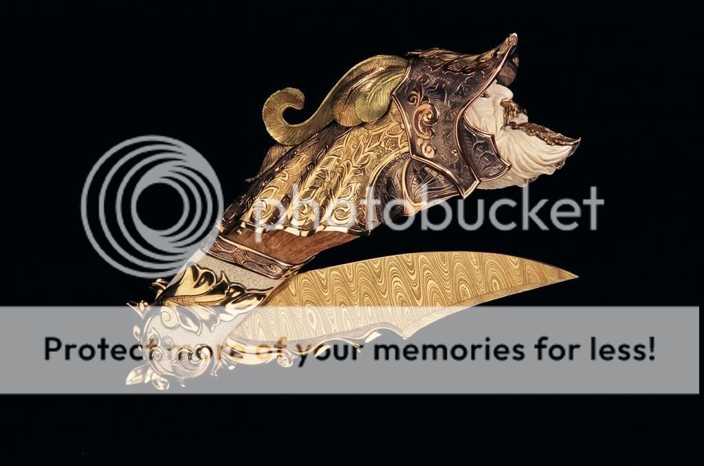

There are the “Art Blades” as demonstrated by Buster Warenski’s monumental King Tut gold dagger blade:

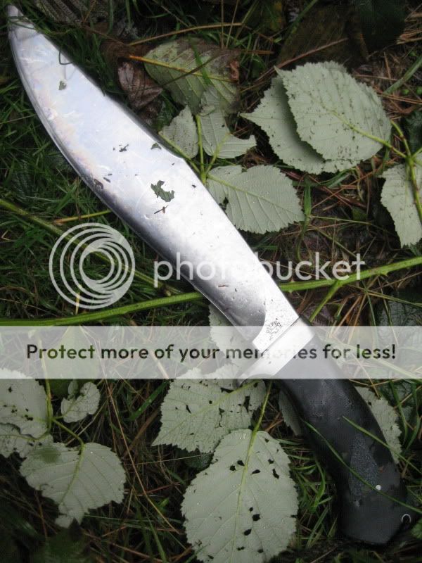

One aspect of a carbon blade is rust, and I've taken the liberty to lift this from Burt Foster's website, (hope that's ok!);
Making knives from carbon steel means I am well aware of the reality of things like rust. Without care, a carbon steel knife will rust and eventually rust away to nothing. Even with constant care, ancient Japanese swords must still be re-polished every 100 years or less to remove the inevitable oxidation that occurs, even under ideal conditions. So even under the best circumstances, rust takes hold, and slowly over time, rust will consume all that I have spent my life making. Since I understand the temporary nature of my work, I appreciate the words of Jesus, encouraging us to give more attention to our eternity than to our today

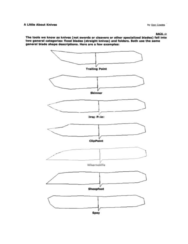

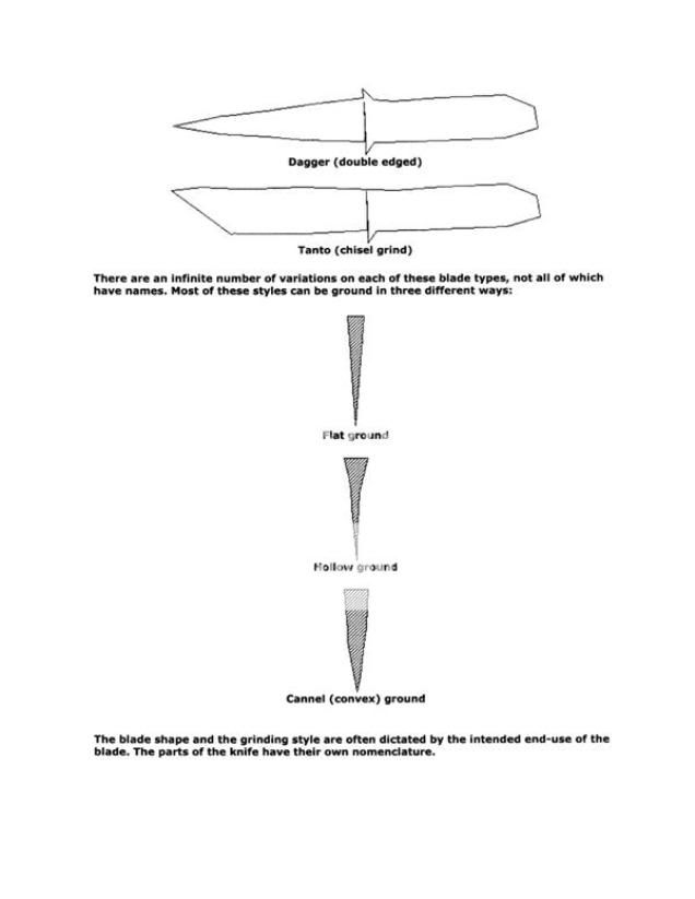

To Jon's point on blade grinds, here's part of a little tutorial by Don Cowles that helped me to learn the basic styles and terminology when I initially started becoming interested in custom knives. Thought it may be beneficial to post here for any viewers who are new to custom knives.
