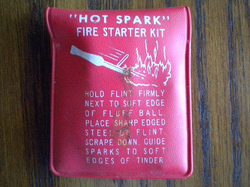

Found this while rummaging through some boxes-
This is late 70's vintage. I remember having a couple of them and using them on a District Camp-o-ree Klondike Derby in the flint & steel fire starting. We were one of the few to get a fire going.
