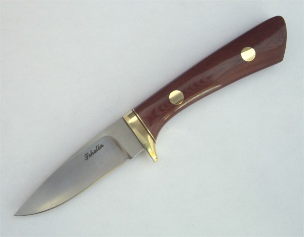

I posted this on my website last week and thought it would be fun to show it here as well:
I made this for my father-in-law in the early 1990's. When he passed away, it came back to me and it's just been sitting in my desk drawer ever since.

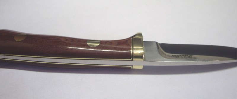

I thought I'd show it here because it uses a neat trick you don't see often nowdays. Rather than using a fiber liner of contrasting color to the red Micarta, I used a red liner and put a sheet of brass between the liner and scale. This makes it look as though there is a painted brass accent line running down the scales, when it actually goes through the entire width of the handle.
Yes, brass was still in vouge back then - nickle silver and stainless were considered "extras."

Still don't see how you worked the brass so it rides up along the guard as well as following the tang. A neat trick indeed.
I used a triangular file to file a V-shaped groove all the way across the face of the brass liner and almost - but not quite - all the way through. Then I bent the brass 90 degrees toward (NOT away from) the groove. This closed the groove up on itself and created a nice square 90 degree angle in the brass.
