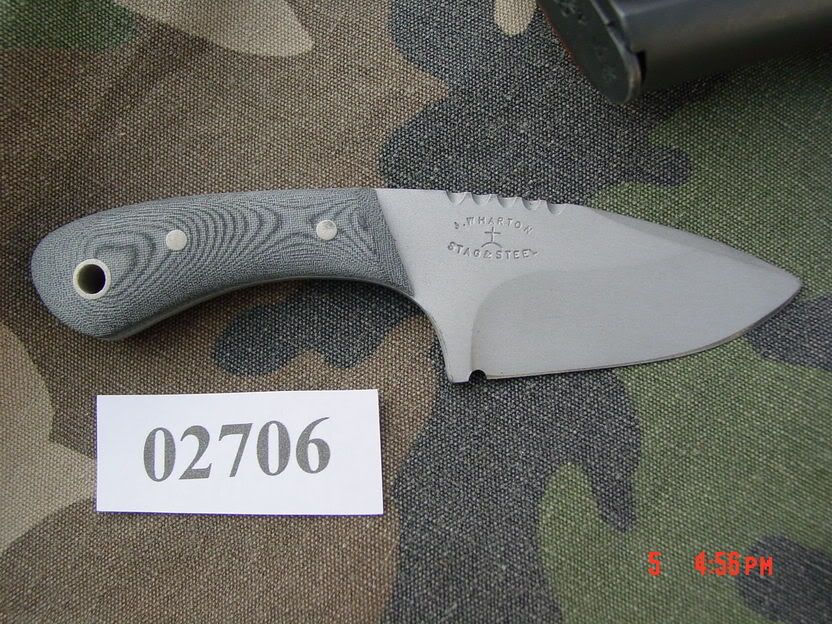

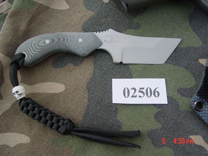

Thanks guys! I went out and bought a HF bead blast cabinet and went after some ATS-34 blades I had ready to buff. The 80 grit glass media just barely turned the blade a dull polished look, like alot of production bead blasted stuff, maybe a little shinier. I had 25# of the glass bead in the cabinet and so I added 25# of 70 grit aluminum oxide and was very pleased with the results. It is slightly coarser than the smooth glass blasted finish, but I ilke it. I think the LEO folks I'm making for will like it too, they don't want any shiny. They will be the ultimate test, when I show them a finished knife.

Gawker, here is a sample of the mixed media bead blast I done on a small knife. Hard to tell in pictures, but may help.
