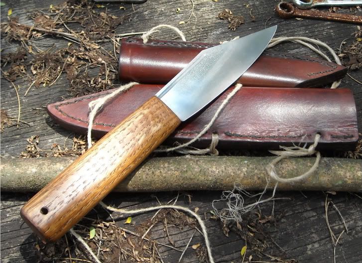

Has anybody else worked with this stuff? I've done four blades over the years-a chef's knife, a bowie and this hu die dao, which is the only one I've done a good etch on:
This thing was groun edge to spine, so none of that is grinding marks-it's all grain.
The pieces I've used had to be drawn to almost bright blue to get them to stop chipping on a brass rod, so the carbon content is right up there.
I've used a bit of it, sourced from old buggy springs. I do a lot of historic blades, so it is perfect for that. I've found that it has a surprisingly high austenizing temp (higher than I was expecting anyway), needs a very fast quenchant, and the edge holding is a little disappointing compared to modern steels. I'm pretty sure no two pieces are exactly alike chemistry-wise, just as no two pieces of wrought iron are. A long slow etch really brings out the beauty of it. I wish I had more of it, I might have enough for 3 more blades....

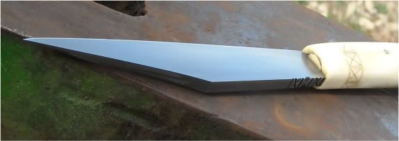

Here are two blades I've made out of it...
The only one of the three blades I did that gets a lot of use is the chef's knife-the other two are fighters so other than the occasional sapling or tatami omote they don't cut much.
The chefs knife holds an edge pretty well, but I did not temper it back as far as the others.
The bowie might well be shear steel-I regularly forget that name...but the Hudie Dao is blister steel.
