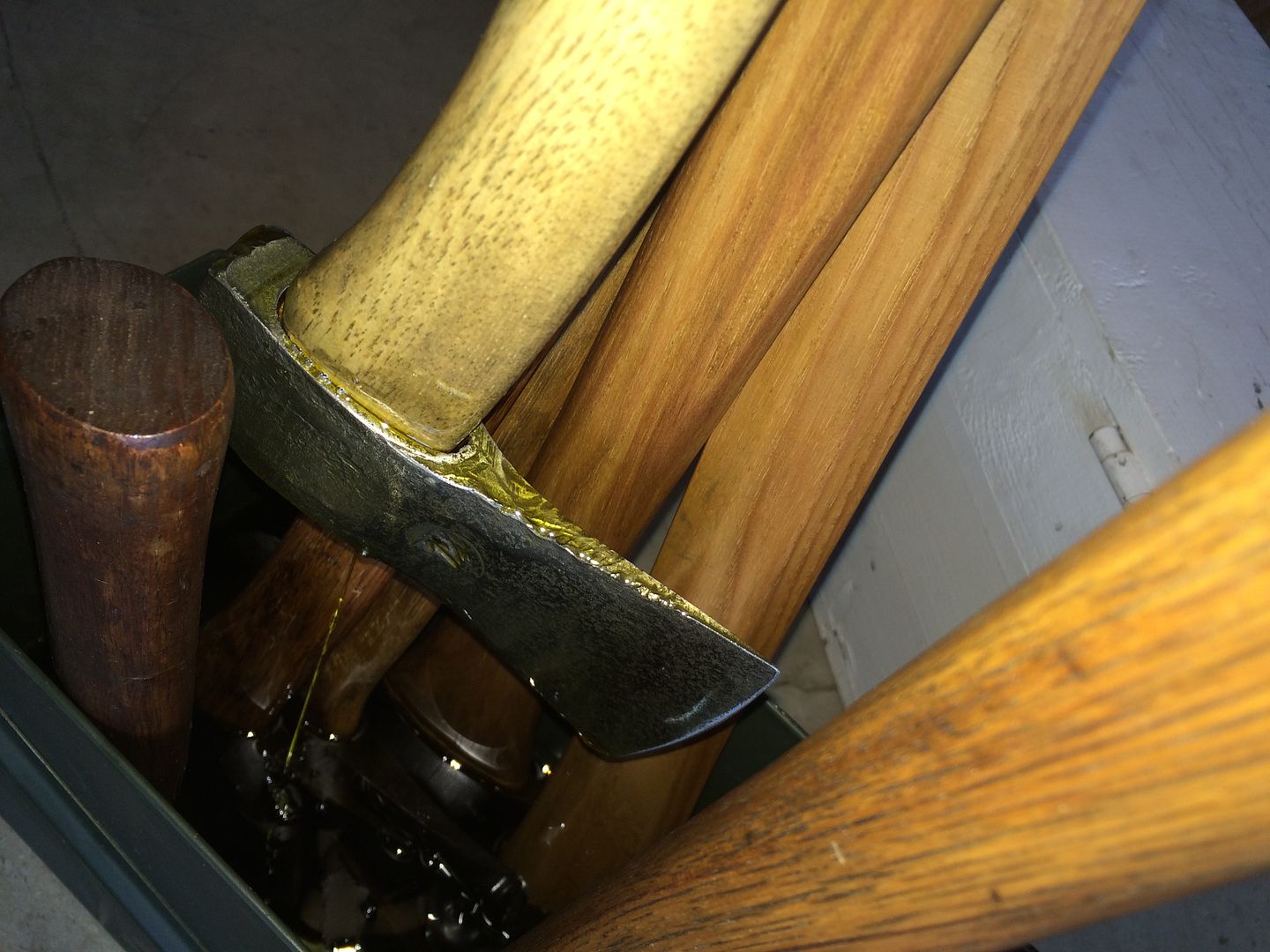

Soaking them like that drives oil into every hole/crevice. But if it can go in, it can come out... I ended up standing them head down on a rack set in something to catch the run off oil then hanging them head up with rags or paper towels wrapped and taped under the heads to catch the seepage. A couple of them leaked oil for several days afterwards. It makes a mess. Did it get BLO in every nook and cranny? For sure.
And there is an ammo can out there now that I probably can't use for much of anything else now...
I haven't done this since. Depending on the wood it comes out kind of "candied" lol. It's kind of overkill but had to try it to make sure...

Well, as was mentioned, I usually leave them out in the sun to cook/bake for a few days afterwards. I lay them down on their side and give them a bath/soak... Then after a few weeks, usually at least 3-4 but sometimes longer (makes it really frustrating to have to wait to use it!), I stand them up on the heads (haft up) so the haft drips off, then I wipe the haft quick with paper towel (or sometimes not) and put it out in the sun to bake. Takes a few days of baking in the sun for it to stop weeping.
As the BLO weeps out a bit it does form somewhat of a gummy surface/coating around the whole tool --head and all. (well, in all fairness, I don't wipe the heads off) I don't mind the gummy BLO coating. Makes them easier to grip. They get really dirty/dark/black pretty quickly but then with use the gummy coating starts to wear off and the proper wood grain shows through. I don't really mind it at all. For me these are tools that I use, often. The gummy stuff on the head looks nasty/disgusting... for a little while, and then it wears off. I don't need it to look pretty, I just want it to work. The two good things are that the wood ends up being really hard/coated/protected, and, the BLO gets into and dries in every bit of the head/eye.
