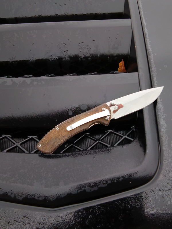

Fun fact. Blood contains iron. Iron that'll rust.
You can remove the iron with vinegar. But....blood also has copper in it and that's the hard to remove stuff.
How do I know? I found a folding knife out at the lake. Where I found it, it had been thrown into the lake from some distance. Low lake level while fishing on some rocks. What looked like a moss covered chunk of wood was a knife. With a strange looking funky coating. All over the knife.
Vinegar bath to start. Left it in for a day. It removed the moss and the, 'rust'. What it didn't remove was the copper.
Long story short. Someone threw a bloody knife in the lake. Taking the time to close the knife before throwing it.
Notice the copper stain on the blade.
