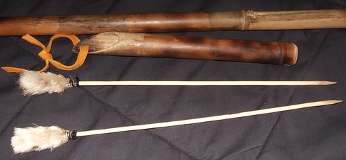

Rivercane Blowgun and bamboo skewer darts I made at Falling Leaves. The container for the darts below the blowgun was purchased from the man who was teaching us.
This video is the exact same way I made my darts.
http://www.youtube.com/watch?v=-lPx9B_gR50
The type of thistle is Scottish Thistle. You pick out the dark bits, then pull the bottom off & knock off the seeds. After the seeds are off, you can see where there is a hollow tube on the end of the white part of the fluff. Place it between your hand and thumb with the tube pointed toward you. In both cases take a bamboo skewer with the string in your teeth, over the tubes, and then pull the skewer under the tubes toward you, and begin rolling away from you binding the fluff with the string.
The blowgun is only about 2 feet or so long. He didn't have anything longer as he ran out of the longer material.
