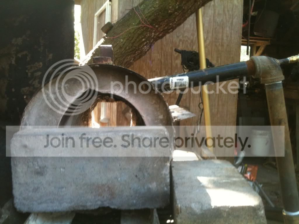

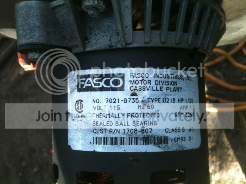

I'll try to get some pics of everything tomorrow. I have the blower attached to some PVC piping to get it down to 1", then gate valve, then a piece of straight pipe, a 90 deg elbow to straight pipe then into the forge. The propane comes into the elbow via a welded on brass pipe. I couldn't find any larger pipe locally to make a mixing chamber after the elbow. The blower I am using is the one pictured in the link below, the one on the left.

This is the info sticker on the blower motor

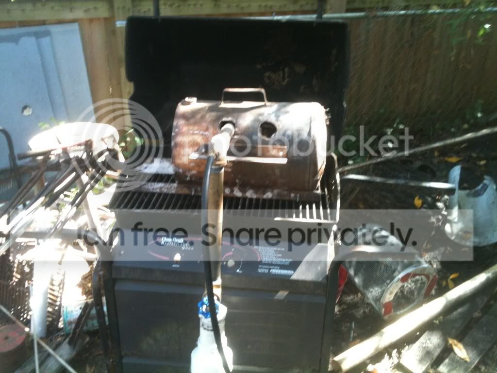

Home for the forge. I'm going to have to cut out a slot for the burner to clear the lid when it is closed. I figured I'd put it in an old grill for a couple of reasons. It won't be out in the open if anyone ever looks in the junk yard I call a back yard. It will be easy to move around like this. One of the main reasons I'm planning on putting it in here is the rain. If It ever starts to rain while I'm forging, All I'll need to do is to cut off the propane, turn off the blower and close the lid.
Side view, well, mostly any how....
