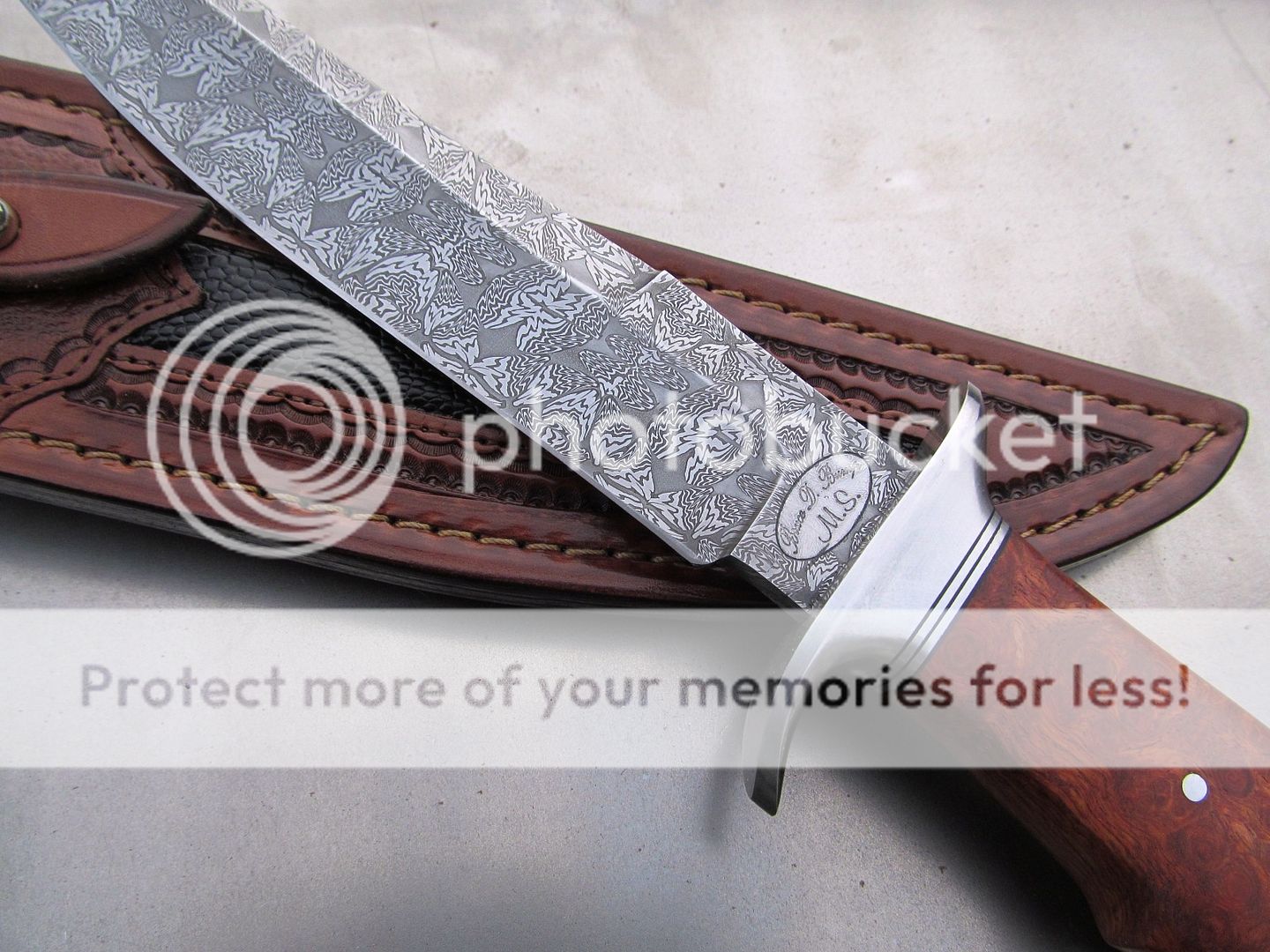

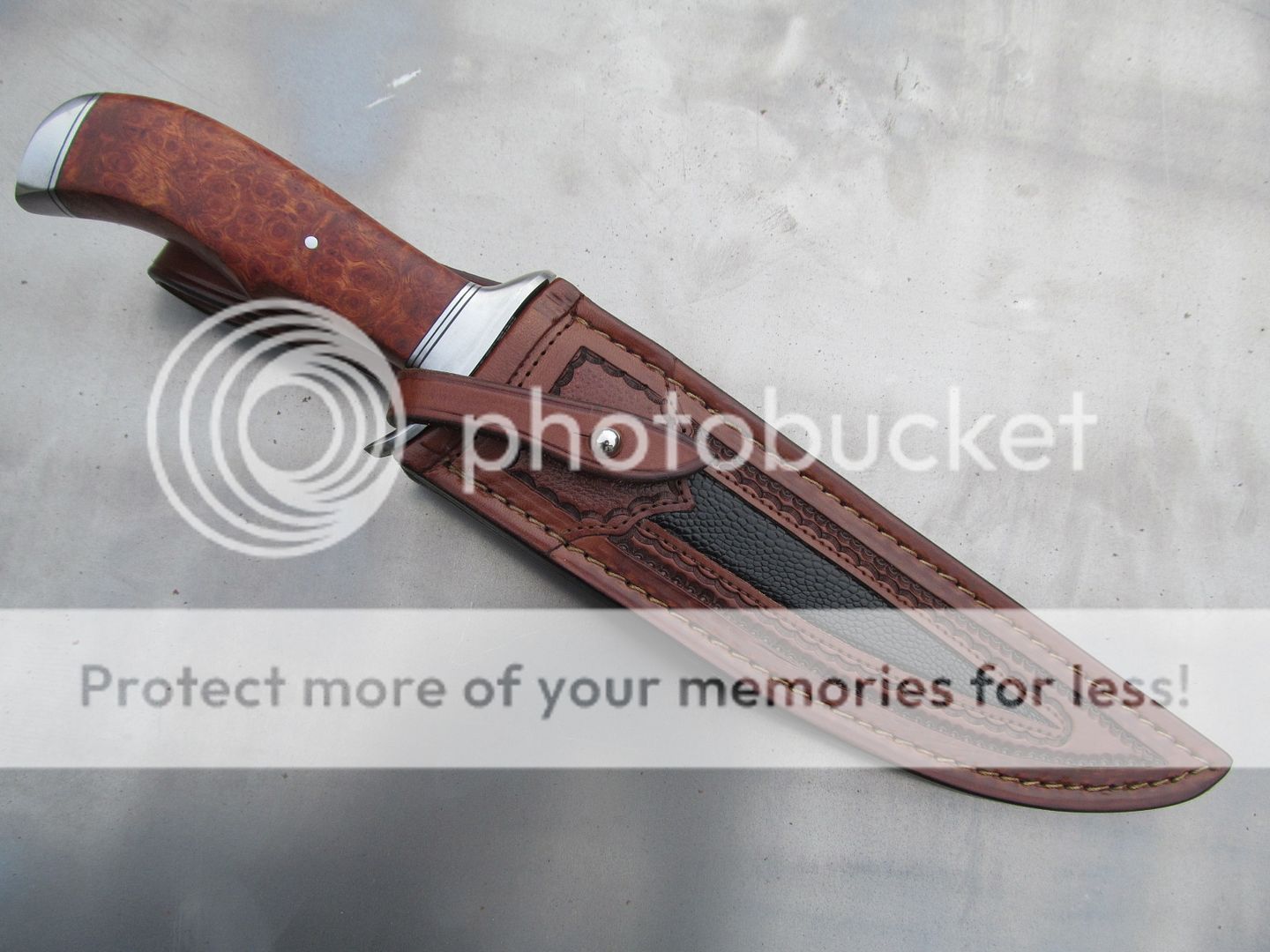

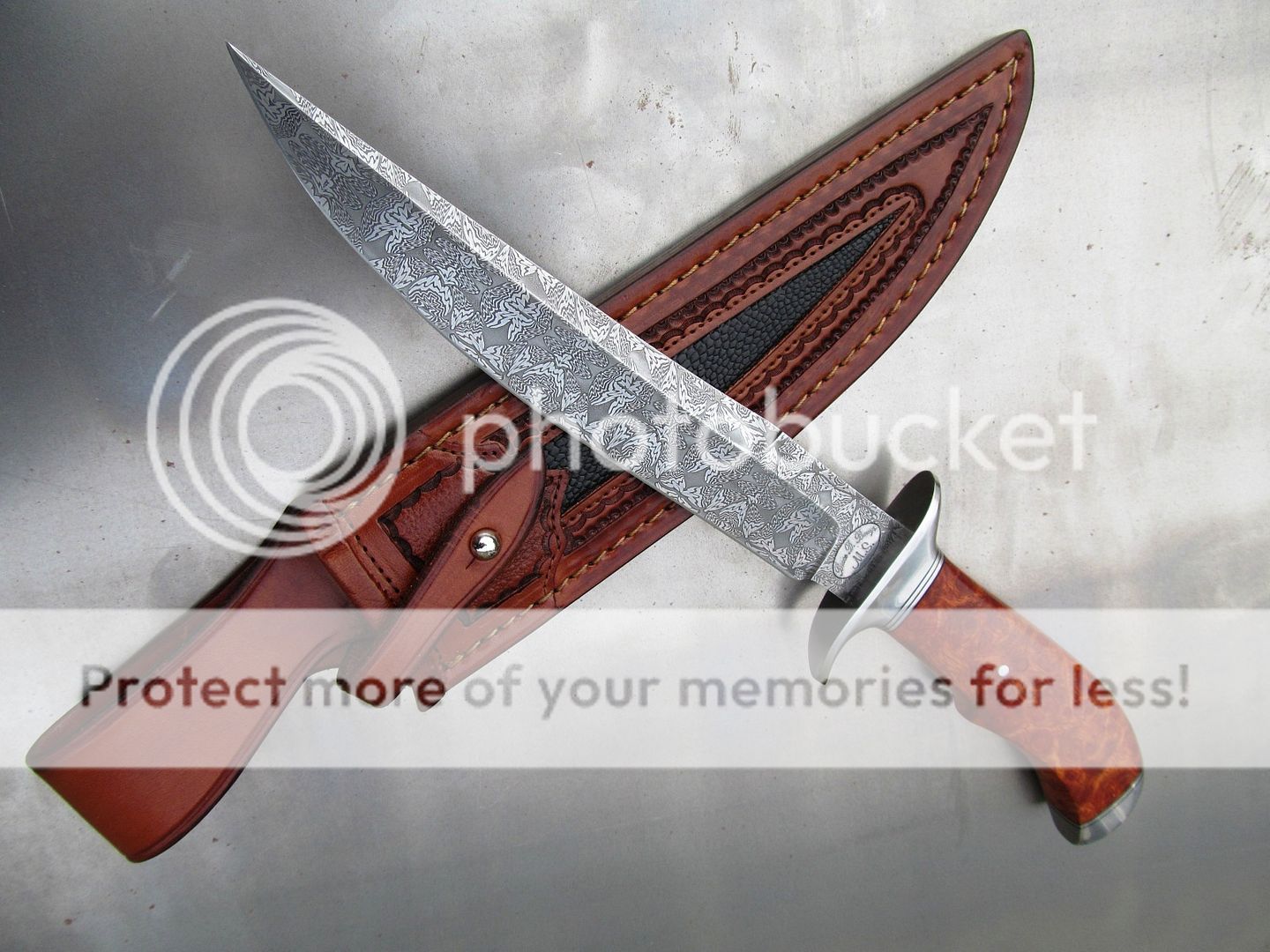

Cannister and tiled damascus, 420 fittings, Afzalia Burl and a Claude Scott sheath. I havent posted one for awhile and thought its time.
Very nice as always Bruce. I do have 1 question, with the handle being pinned how is the pommel attached ? I really like the looks of that pommel.. And that Damascus is amazing.......
Love that bowie! The damascus is gorgeous and the Afzalia is a perfect compliment.
Thanks Gentlemen
Jim,
This one has a 3/4 length tang. The pommel is drilled partially into the stainless for two 1/4" steel pins. The pins are silver brazed into the holes and epoxed into the wood.

Bruce, Another awesome piece by you. That damascus really rocks my boat. Glad to see you post up again

Very cool, Angel also thought the damascus looks like butterflies. I keep looking for a trigger. Very nice Bruce.
Beautiful. The blade with that long clip point is ALMOST a dagger.
I absolutely live the lines of the blade. I will add a similar one in one of your feather patterns to my Christmas wishlist that I give my family every year. :rolleyes: ;)
Seriously graceful lines on the blade.

Bruce thats a beauty Will it be at the Arkansas show I would love to see it first hand.
Really nice piece and very recognizable as a Bump even without seeing that good looking maker's mark.
