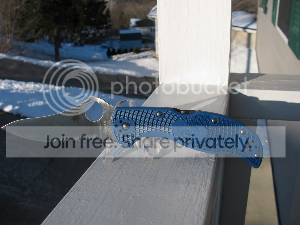

It was a black Stretch...Ridgeway Blue Cerakote on the FRN scales and back spacer and now it is one of a kind! :)

Here is a picture courtesy of HistoricalMan, came in ZDP198:

I do Duracoat work as well....... the process is the same minus the baking part for Cerakote......degrease, media blast, blow off, apply material and cure.

I'm impressed you got it into all the little nooks and crannies on the handle, looks really sharp!
I'm a professional man!! LOL Plus a bit of a perfectionist! I won't send anything out of my shop I would not be happy to have.
Nice work! How durable is the Cerakote finish? I was under the impression that most finishes wouldn't adhere well to materials like fiberglass reinforced nylon?
It is pretty durable....with proper surface prep it will go on about anything....as long as it is not really flexible....like the clicky on a light.
