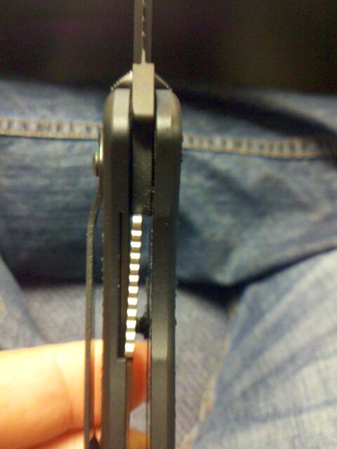

The Blur's liner lock is plenty strong. Lock-up is beyond solid. I would totally recommend it. Here's a pic. I had to use a "silent cam" app cuz I'm at work. Please excuse the quality.

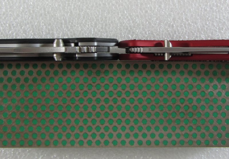

I know that if you search around a bit here, you'll find a thread or two in which someone posted side-by-side pictures of a Blur and a 0350. Notably, it shows the thickness difference between the two. In general, every part of the Blur is a bit thinner than the corresponding part on the 0350 (blade stock is slightly thinner, liner is slightly thinner) and that adds up to the Blur being considerably thinner than the 0350 overall (also helps that the Blur's liner is embedded in the handle vs. the G10 and steel liners of the 0350). I've never had either of those knives so I can't speak to their relative "toughness" but I believe everyone's testimonies about both knives.
Here's a comparison of the thickness between the Blur and 0350. The Blur isn't as stout as the 0350, but it is still plenty strong. There are some more pics comparing the Blur and 0350 in this thread.
