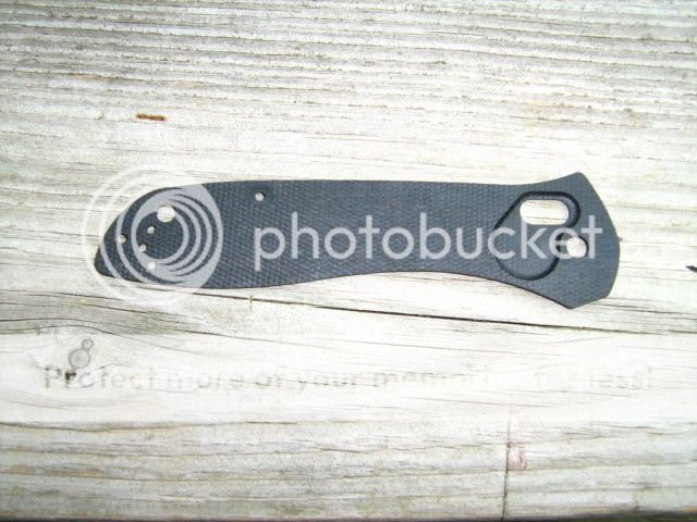

Could you post one more pictures of the scales upside down?
Great pics BTW.
I'll assume by upside down you mean the inside part of the scale? If so, I'll take one of them off sometime tomorrow afternoon and get a picture for you. It's pretty simple on the inside, all flat except for a cut out where the Omega springs live.

As promised, here's the inside of one of the scales. The G-10 is finished very smoothly all the way around. Fit and finish are superb.
