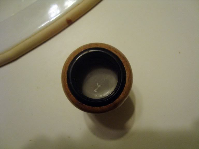

The first thing I did was soak the brush in boiling water to see if that would loosen up the epoxy, but it didn't work. then I just took a Olfa knife and cut the knot right at the edge of the plastic ring and grabbed a 1/2 drill bit and hand drill. Drilling at slow speed as close to the middle of the remaining knot I went till I saw wood chips.
Well I didn't see any wood chips the drill just suddenly sank in an extra 1/2 so I stopped and looked to see what I had. There was a nice gap under the knot. With the drilling out of the way I took a small chisel and started working out small pieces of the knot moving towards the plastic ring. With about 1/4 of the knot removed the epoxy let loose and the remaining knot came out with my fingers.
Time for a measure with a digital vernier caliper to see what the actual measurement was. It turned out to be 22mm with the plastic ring/sleeve still in the handle. Perfect I wasn't going to have to plug the hole and re-bore it:thumbup:

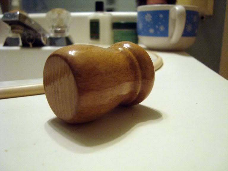

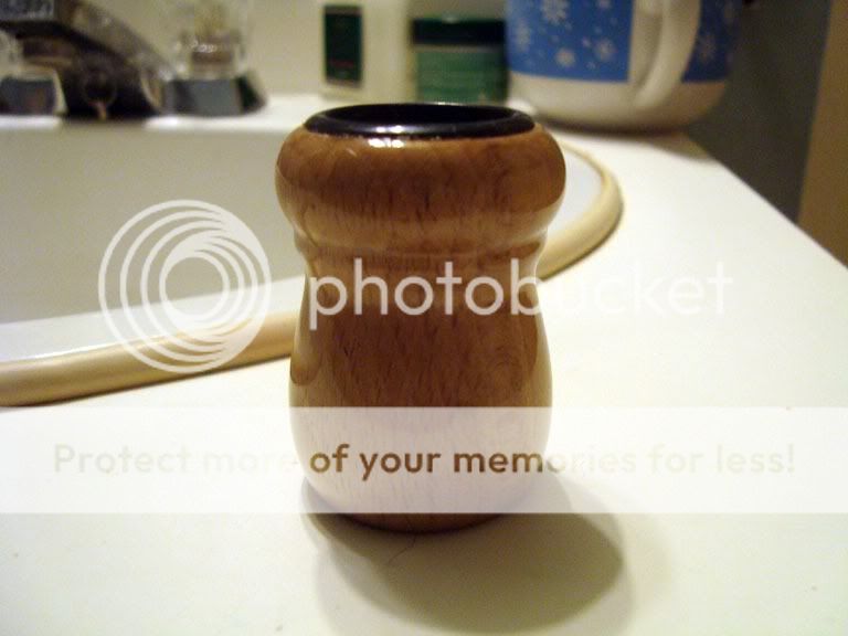

I then lightly sanded the handle to remove the Omega graphic, and wanting to keep this conversion on the cheap I gave it a few coats of mag wheel clear from dupli color I had laying around. It is meant to withstand the elements, so life on a shaving brush should be easy.
Here is what the handle looks like now
No more Omega emblem, or pure bristle written on it. Really high gloss, that I have tested with a wet soapy hand. I also trimmed down the plastic ring/sleeve a couple of mm so the total set depth is now 17mm. That means that when I set my new knot my loft should be right around 48mm. The super badger I bought has a 53mm loft and a 23mm knot, so this one should have a touch more backbone, but the silvertip is softer so they should be pretty close on overall feel.

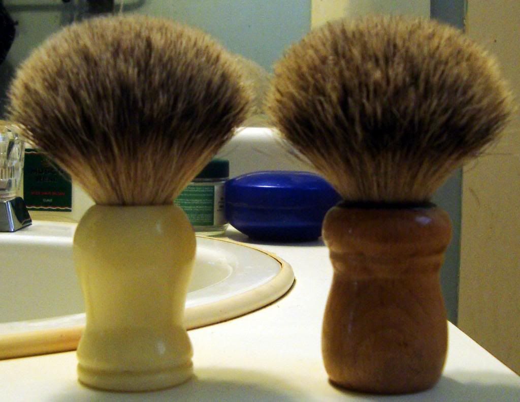

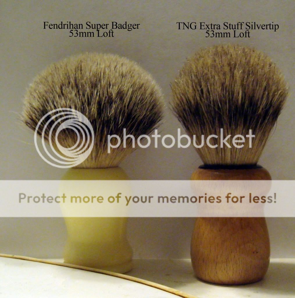

The knot came in today and I was going to wait till tomorrow to set it because it had been stuffed in an envelope for 2 weeks. It returned to its proper shape in no time so I figured what the heck lets get that sucker in:D

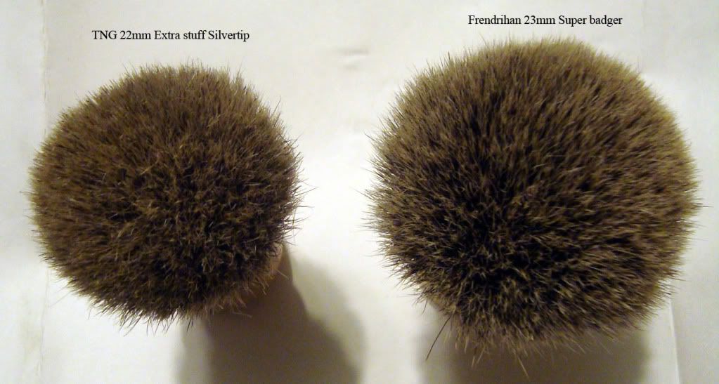

I wasn't able to get the lower loft I originally thought I wanted, but didn't drill it out to get it. I have been using the Fendrihan brush for 2 weeks now and am really liking the way it feels so it is set at a measured 53mm of loft. the Fendrihan says it is set at 53mm but I measure it at 52mm:confused: the TNG/Omega looks much taller but the black ring causes an optical illusion.
A view from the top, how much will this one bloom when it hits the water tomorrow night?
It looks as if when the TNG relaxes a little more it'll be right there. BTW nice work on the re-knotting

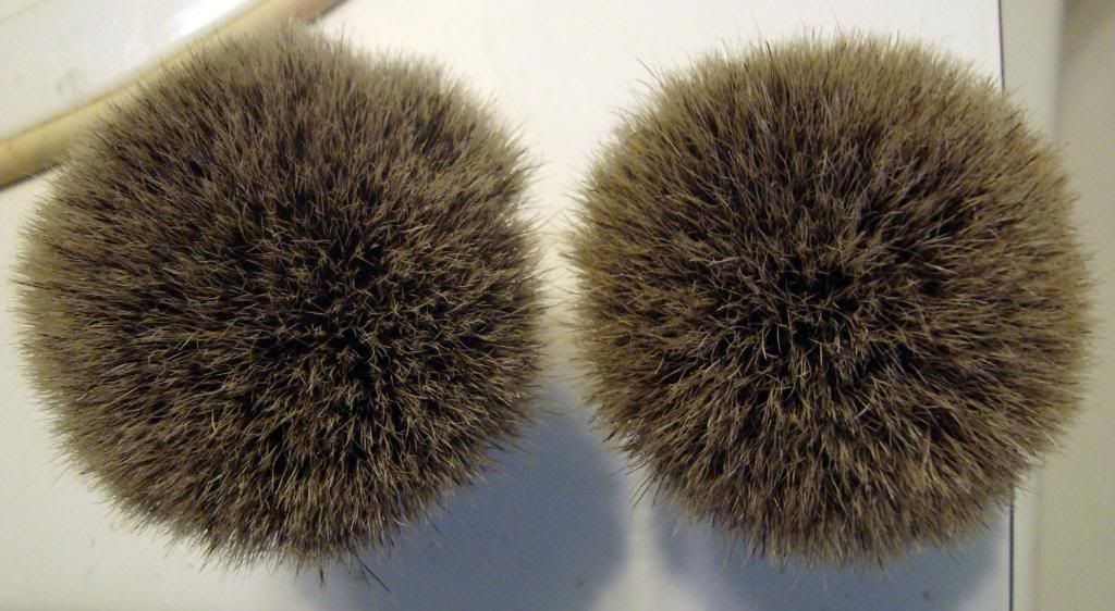

So as promised, here are the pictures of the two brushes side by side. The Omega/TNG is on the right in both pictures
Both brushes are very dense and the TNG knot bloomed nicely:thumbup:
