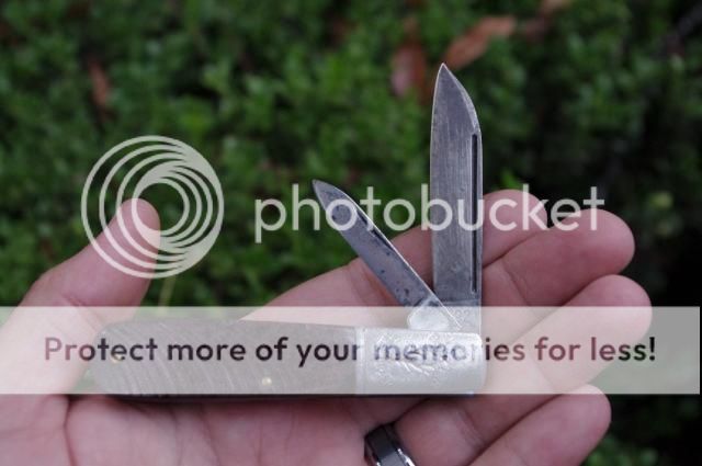

I'm not sure I can answer your questions about the history of these knives. You can find some information about Boker's history and tang stamps just doing a google search for Boker tang stamp. Not sure I've see anything specifically about barlows. These old knives are out there if you look hard enough. I found this one about 2 months ago at a local antique mall. It was in pretty rough shape but with some care it still has plenty on life left in it. If you just want to try one out and don't mine a "user" I'd be glad to send this guy to you.

Can I see a picture of the 3 pinned delrin boker barlow. I've never seen a 3 pin delrin in all my research and hunting so far.
