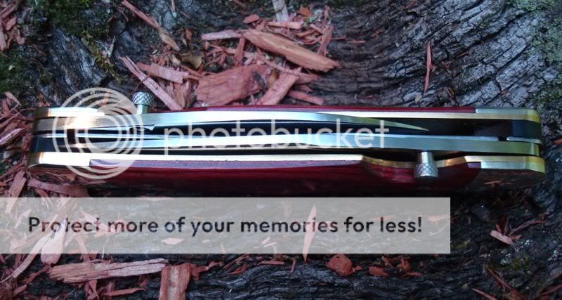

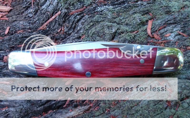

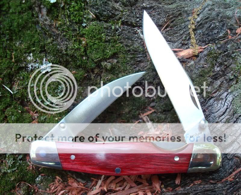

I bought a Kershaw Double Cross about a month ago. Basically I was looking for the same thing , a one handed slippie style that I could carry in dress slacks.
It was on sale at the Sportsman's Guide website.
I haven't handled a Copperliner for comparison, but the Double Cross is a one-handed liner-lock, there's no back-spring. The two blades share a single locking liner ( bent at each end). Kershaw even added nail-nicks to complete the traditional look.
It's a very well made piece and further proves that Kershaw can pretty much pull anything off.

Impressive looking knife, those are the best pics of it I have seen. Without backsprings have you had any trouble with it coming open in your pocket? I'd imagine its setup fairly tight to prevent that.
Thanks, I'm really a lousy photographer, but I got a new camera:)
No it won't open in your pocket, the blades are firm and it has a detent for each blade too.
