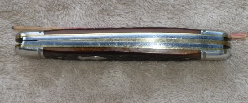

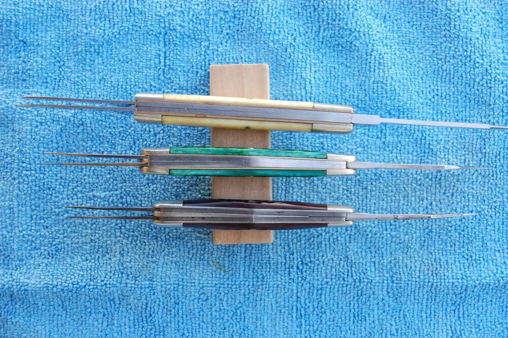

Yes, the split backspring (one for each small blade with the other end of both for the main) is pretty much standard for whittler pattern knives. Some have a tapered spacer or liner between the springs at the small blade end, earning them the name splitback whittler.
Edit to add picture. Top to bottom: Parker Doc's Whittling Knife with flat springs, Hen and Rooster with tapered springs, Case splitback whittler.

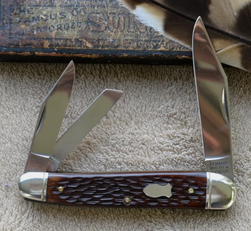

Schrade did this as well on the 804 pattern. The split backs are a sweet whittler pattern. :thumbup:
It gives you a thick, stout main blade for hard work and two small, thin blades for detail. The most common seems to be a small pen blade for belly and a small coping blade for straight. I find I do more of my whittling with the smaller blades and larger tasks (like cutting off the stick to whittle ;)) with the main blade.
As far as the springs go, using 3 springs (one for each blade) would result in either a thinner main blade or a much thicker knife
