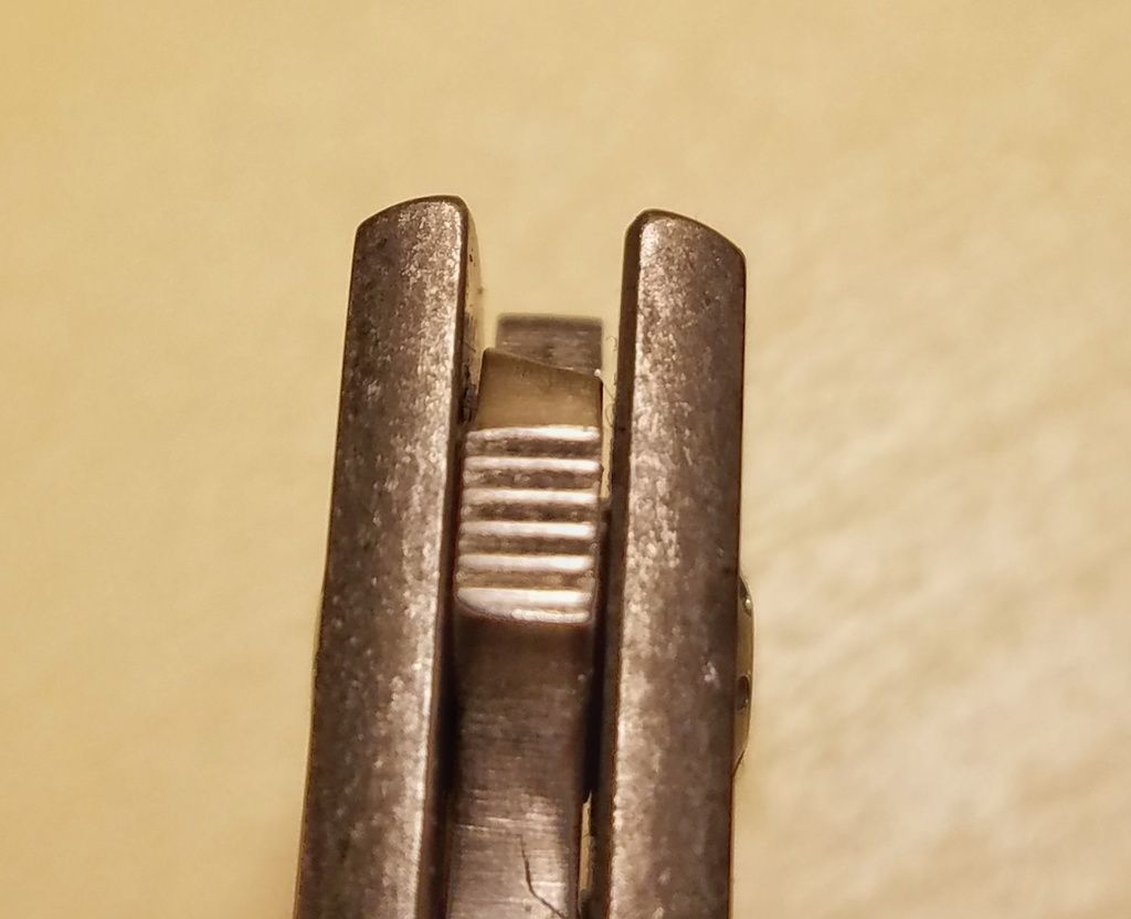

It arrived on Tuesday, and low and behold, it's a stinker out of the box - the blade is off-center, and the lockface one again has a steep radius with no lock insert. This is the exact problem Boker Plus had with any number of its old titanium-on-steel lock interfaces. Lockslip, lockslip everywhere. Perhaps unsurprisingly, within hours it developed lockslip. I became delusionally confident that it just needed to break in more, as it seemed to go away as the lockbar noticeably began to travel further towards 100% lockup. Alas, tonight the lockslip has returned. We're talking about a lockbar traveling a good 20% in the span of two days.
I genuinely just don't get it; they collaborate with of the best knifemakers out there, can none of them show them how to cut a lockface properly? How do they avoid this issue with some models, and then have it pop up with others? Why not just standardize your lock geometry? Luckily GP Knives are good people and are willing to exchange it, we'll see if the replacement is any better. I fear it's more an issue with the model itself than my specific instance.
Lockface, for reference:
Sorry to hear that. I have the original UT with plain titanium handles and I love it... mostly for the way it carries. I always get a twinge of nerves when cutting anything more robust than an apple with it as it feels like a fragile scalpel in hand. But I love it nonetheless. The factory edge was less than 1 mm in depth but otherwise I've had no issues with mine.
Is that a crack in the blade in the center toward the bottom of your photo?

Disheartening to hear about the lock interface and F&F issues on this one. I was eyeballin' this model due to the larger size. I will be passing on it now, though.
That's too bad. My only Boker is an Oberland Arms EDW and it seems to be extremely made (fit, finish, etc. is excellent) and durable knife.
Update: I returned my Urban Trapper Grand to GP Knives, who replaced it with an example with no problems so far. Now I'm quite impressed with this knife.
