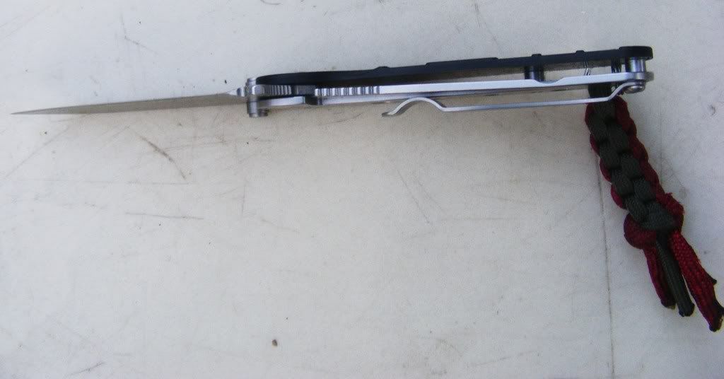

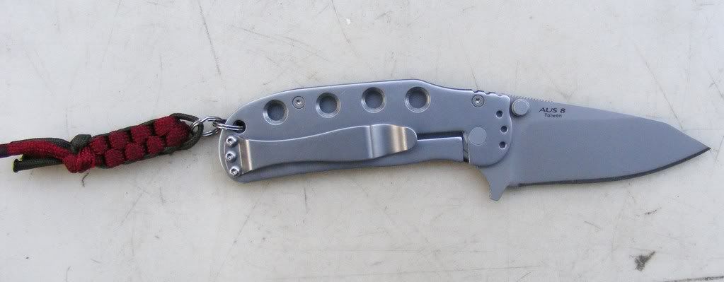

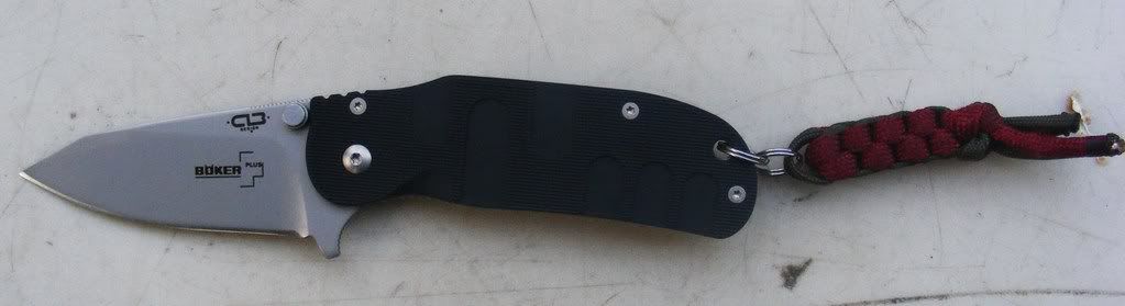

I just got my first Trance after about two years of using the Subcom. I can't believe I waited that long, as I wanted a CLB design with a flipper since I saw them. This one is the clip point, but I would've bought both this and the drop point if they were in stock. The Trance is 3.2 ounces in weight, and fits nicely in your pocket. The model number is 590, and is made in Taiwan. Here are the details...
Handle Details: The Trance is 3-1/2" long when closed. It has dual stainless steel liners, one locking. The non-locking side has a black FRN scale attached. The knife locks via framelock, which is jimped for a non-slip finger placement. The handles are held together with six (three on each side) Torx (T-6) screws, one of which is longer than the rest. This is the middle screw for the pocket clip, and it goes all the way through the frame and into the spacer in the butt of the knife. Now, the pocket clip is reversible for tip up or tip down carry, right hand only, but this longer screw makes placement tip-down nearly impossible. The clip is very retentive without making the knife hard to draw. A lanyard hole is drilled into the butt. The right side (the locking side) of the frame also has four holes drilled in, I assume to give your fingers a nice spot to rest when opening the knife. The back of the handle is open to allow debris and pocket lint to be blown out, and there's jimping near the blade's back. The FRN scale has nice texturing and doesn't abrade or hurt the hand. The blade locks open solidly with no play. The blade can be loosened or tightened with a Torx (T-8) screw.

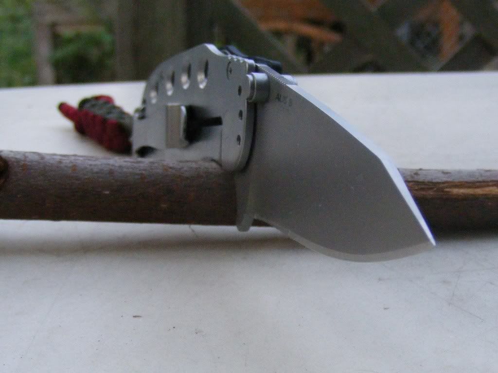

Blade Details: The Trance has a nice blade, and it's 2-2/4" long. It's made of AUS-8 stainless, and is flat ground (not hollow ground). The left side of the blade has the CLB logo above the Boker Plus logo, while the right side has "AUS 8" above "Taiwan" on it. Dual thumb studs make the knife very easy to open, and this is made even easier with the placement of a flipper. When locked open, this flipper makes slipping your hand forward onto the blade nearly impossible. The flipper has jimping, too. Finer jimping is on the back of the blade. The blade has a nylon washer on each side for even smoother opening. This blade cuts very nicely.
The Trance is one of boker's best designs in a folder, and can be had for around $30. Major props to Chad Los Banos (Daywalker here) for the design; no wonder everybody likes it.
You can find out more about the Trance from Boker's website here... http://www.boker.de/us/index.php?c=3000&a=01BO590&s1=trance&s2=0&s3=9999&p=&pp=0
Here are some photos of the Trance...
Reverse side...
From the back...
The locking liner...
