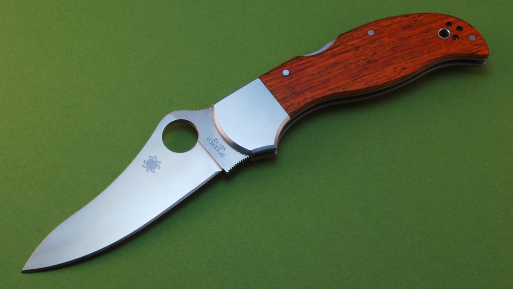

I cannot add anything about bolsters, to what was said above, except that I love them.
Me too Roman. :) Seriously hoping this one makes it to production...
This ^ I love bolsters. Pity not too many (mainly modern) knives I like have them.
+1
Still I have about 30 bolstered Spydies: Persians, Kopas, Navaja, M-Dyads, Damascus Delicas. Will buy more :). I think that Caly3.5 with bolsters will look fantastic
Paul,
I would take even limited run. I need just one. :)
